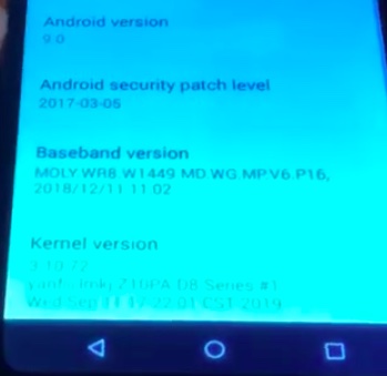

Then there's this....
Apparently the Android security patch level is two years before Android 9 even came out?
The Baseband identifier string corresponds to the discontinued Mediatek MT6580 SoC. See my previous comments about Xgody using old or recycled parts.
Also the 3.10 Kernel version, which is from 2013 and was used in Android 4.x.
Of course that's in addition to having the stock Android 4.x icon set, I've already mentioned.
