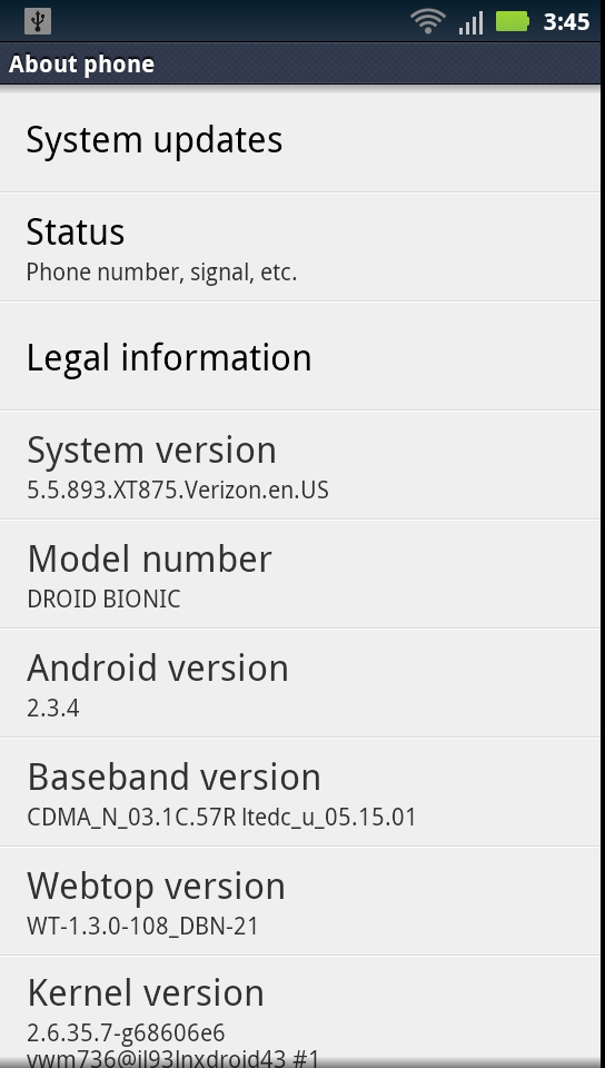

Root y'all gonna love this....
I just followed instructions - tried 3 different ways, and a very obscure one finally worked.
I was more guinea pig than anything lol - but hey, I put my device on the line so we can appease those who applied the update(s) and want to revert.
Here is the proof of my phone:
I'm now applying the 5.9.901 update.
And if I can reproduce the reversion to stock using this as well, then guess what? I can participate in soak tests! :D

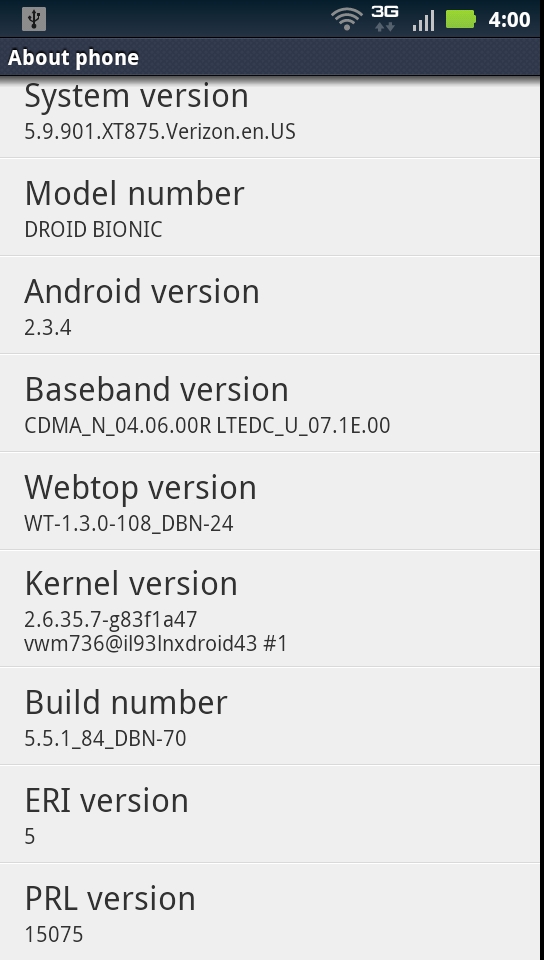

Nice work John! thanks for being the guinea pig. I see the kernels and radio for 5.9.901 are different from my 5.8.894. Did they change again with the newest update?
That is the latest update thus far, that we've found - but yeah, it is definitely different.
However, if my theory holds true, then from here on out we should have a nearly flawless system of reverting any time we want.

I just reverted my phone from 5.7.893 to 5.5.886 fully stock to apply the 5.5.893 update.
I'm exhausted though - writeup tomorrow. I still gotta apply 901 and then get safe strap installed and get ICS running too
