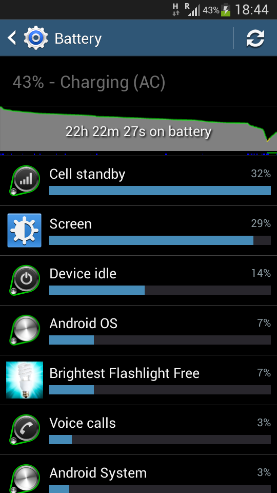

What do you see is using power when you go to: Settings > Battery?
Nothing out of the ordinary
I'm also attaching screenshot of the battery usage stats.

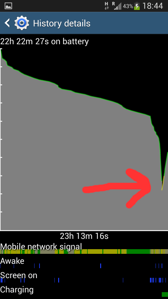

And here's the enlarged graph,
The point marked with the red arrow is where the phone shut down (without ever reaching 0).

Your cell standby is very high. This should not happen except maybe when the phone is doing nothing at all since the last charge (which resets battery stats) except sitting on it's butt. Even then, cell standby may not be at the top of the power usage list.
High cell standby is usually caused by the phone having a weak or nonexistent signal. The phone keeps searching for a signal strong enough to lock onto, which uses quite a bit of power.
Check if you have a decent signal where you've been leaving the phone during the time covered in the shots you sent. If not, see if you can find a spot with a better signal and if so try leaving the phone there and if the power drain is significantly improved.

First of all, during the time covered by the screenshot I almost didn't use the phone at all. So maybe it make sense that cell standby is on top of the list.
The signal here is fine, I don't think it caused the drop.

The thing is, it shuts down at above 20% (not 5%)
