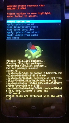

phone tried to update to kitkat but shut off during update now the recovery is not working tried using apply update from sdcard says E:faild to mount/sdcard (no such file or directory) did a md5 cheak
That happened to me when I was trying to update with a rooted ROM. If you're rooted install flashify from the play store and either reflash the old recovery (the one in your screenshot is a new version from the original) and install a completely stock no root B05 ROM and then update.
Alternatively ,if you're rooted, you can use flashify to flash philz and then flash the update manually. There are instructions for manually updating in other threads here on site.
how do i get CWM/PhilZ, i had it before but now its gone. i put it with the brick tool thing, do i do that again or is there another way
If you are rooted, flashify usually works well for installing recoveries. You can also visit the PhilZ thread and there are instructions on how to install it. Or, you can use the unbrick tool again.
