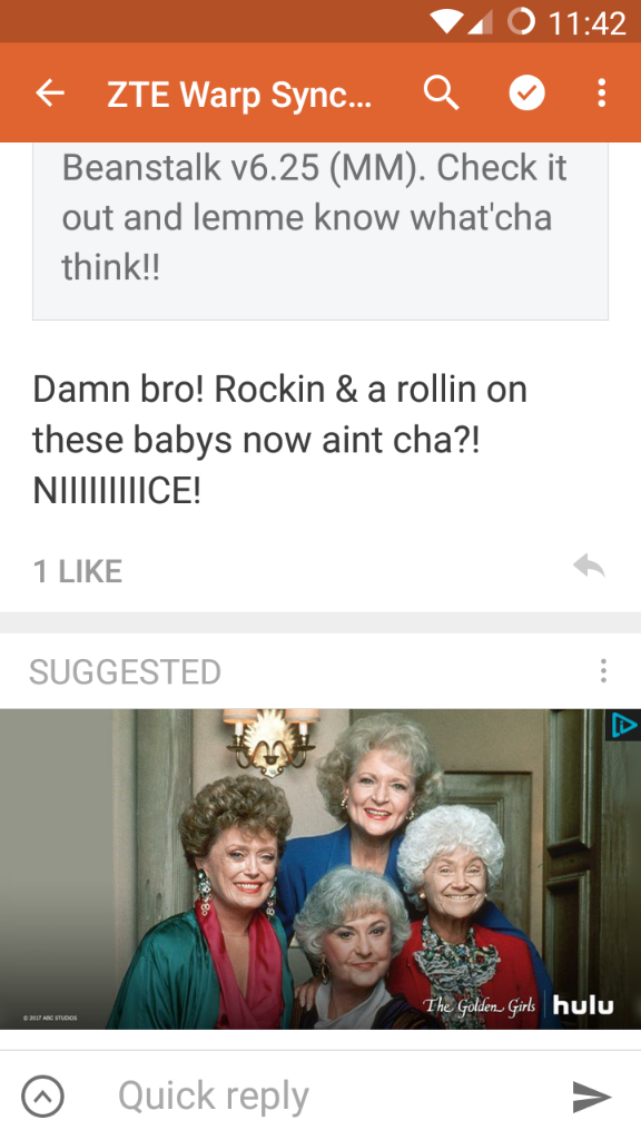

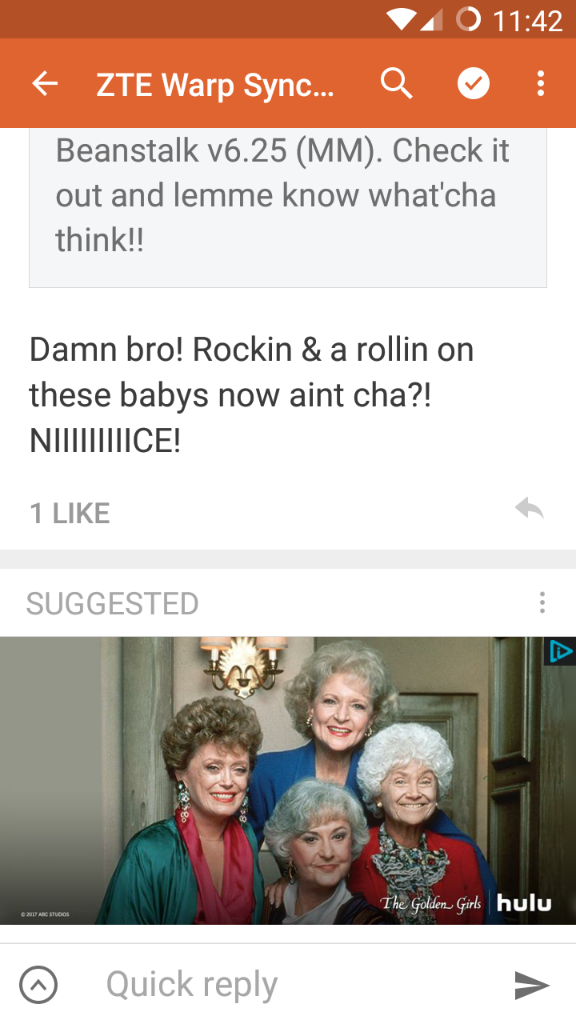

Oh how nice a pic of all you're main as well as side chicks a bcrichster!? [emoji23]
