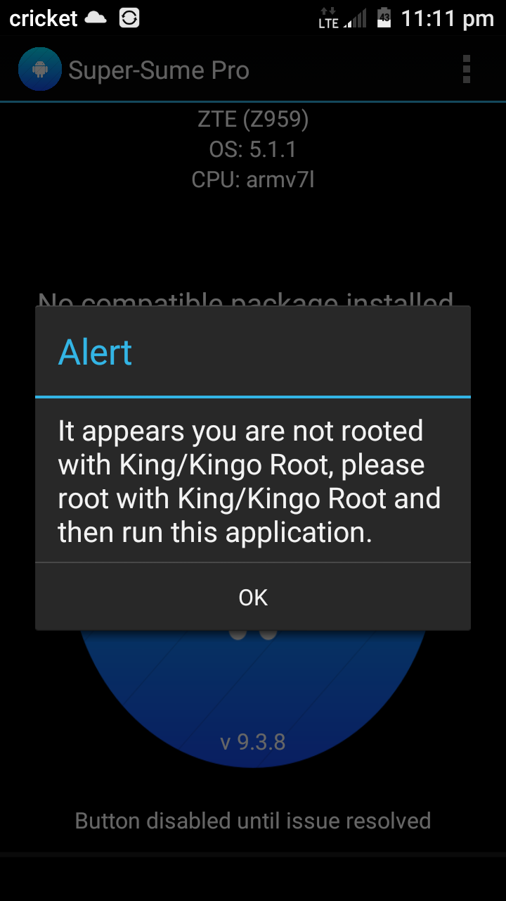

Yo. I just got the grand x3 and successfully rooted. I'm now trying to remove the Kingo junk with supersume app. I get this though..... anyone been able to do this yet?
