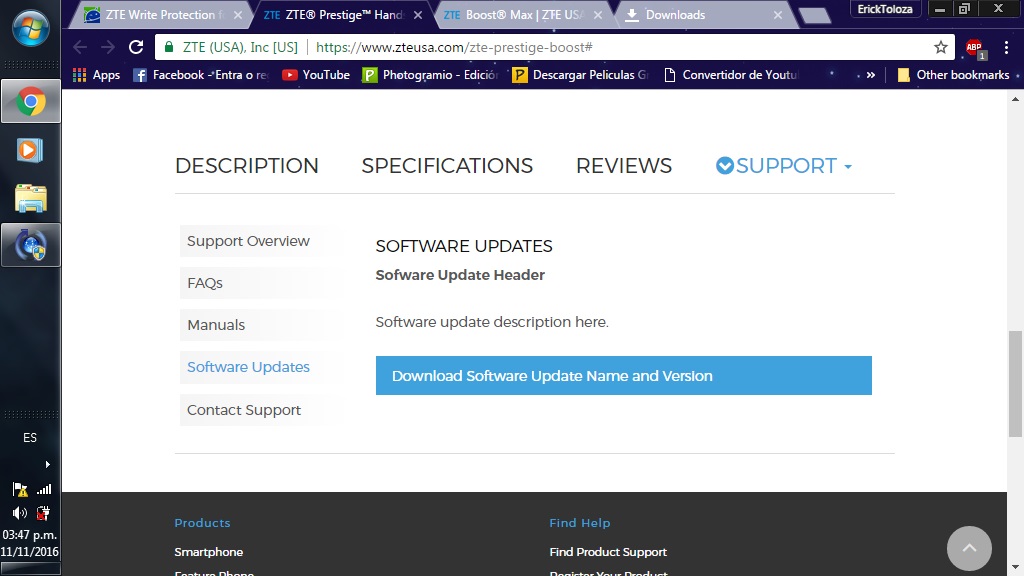

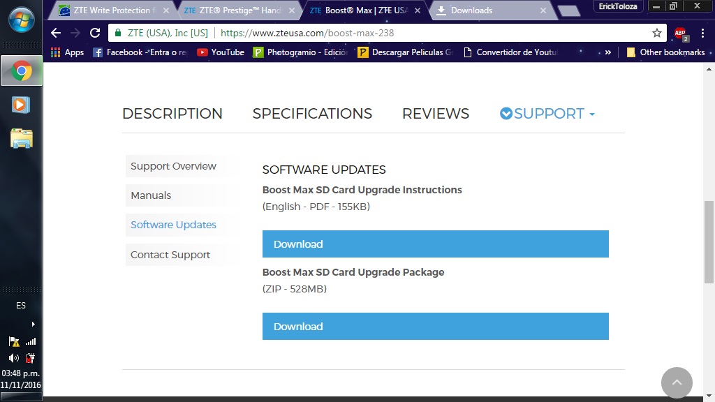

When i click on Software update it just says "Download Software update name and version" and when i click it the page just scroll up automatically... I tried with another model and the software is uploaded, Is like they don't have software update for a ZTE Prestige N9132 because in the page of the Device "Boost Max" there is a software update for that device. I let you 2 screenshots from what i'm saying, Sorry for bad english, I can't speak too much..

When i click on Software update it just says "Download Software update name and version" and when i click it the page just scroll up automatically... I tried with another model and the software is uploaded, Is like they don't have software update for a ZTE Prestige N9132 because in the page of the Device "Boost Max" there is a software update for that device. I let you 2 screenshots from what i'm saying, Sorry for bad english, I can't speak too much..View attachment 111755 View attachment 111754
Contact zte support thru the phone they will be able to guide you, or give you a direct link to the download..it might even be a typing error on their part .....after that copy it to your SD card and update it thru recovery mode.
