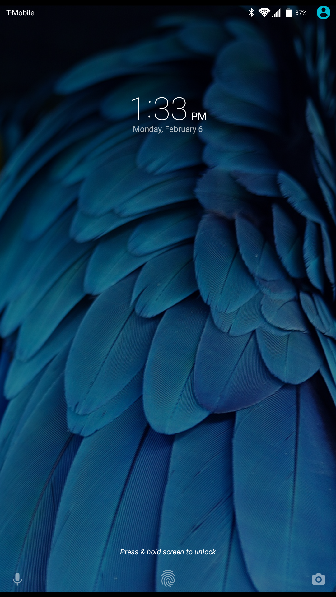

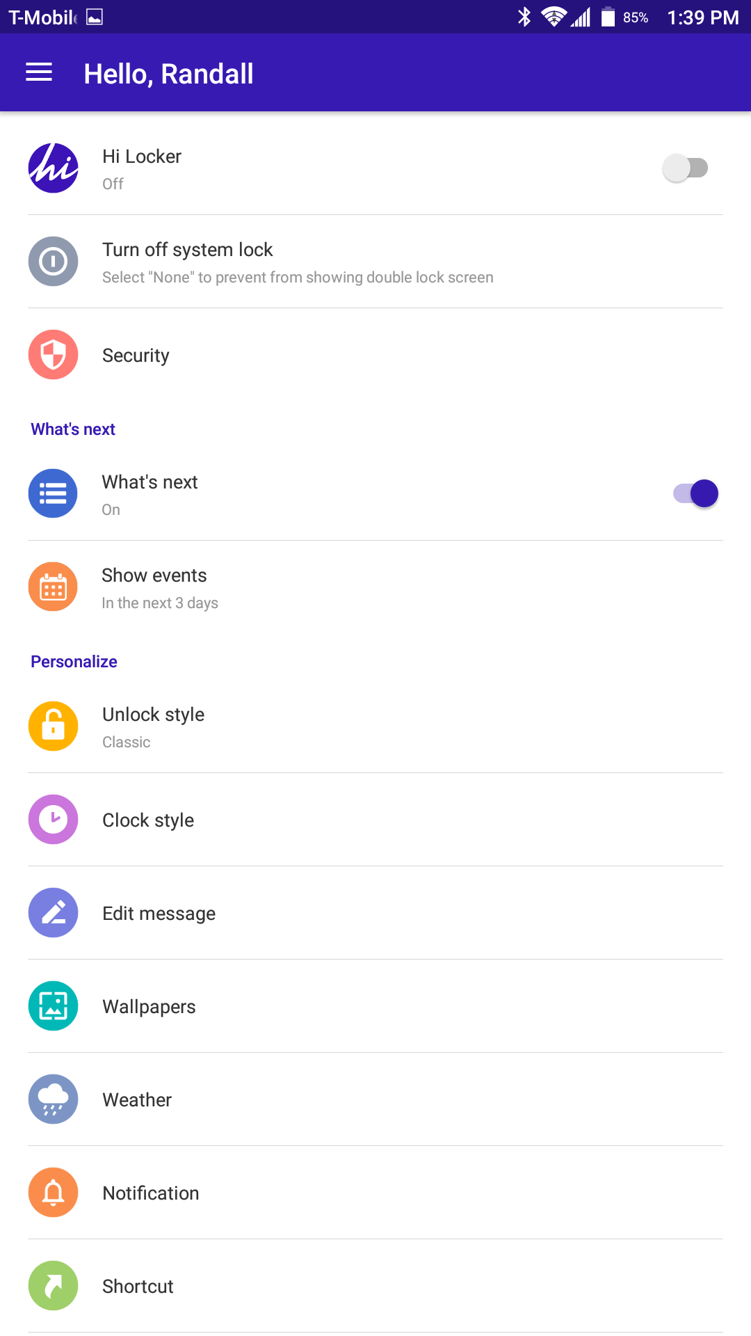

I am at 320 DPI and have a functioning stock lockscreen somehow. This is what worked for me. I disabled lockscreen then changed DPI to 320. I downloaded hi locker pro and set it up. I gave it all permissions and enabled in accessibility, then, in hi locker settings I set up fingerprint unlock. It forced me to set up a backup method of course, I set a pin and selected no notification on lockscreen. Upon turning on the phone I noticed that I had 2 lockscreens to unlock. So within hi locker I disabled hi locker but left it installed. I now have stock lockscreen at 320 DPI.
