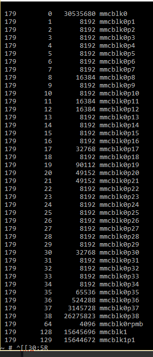

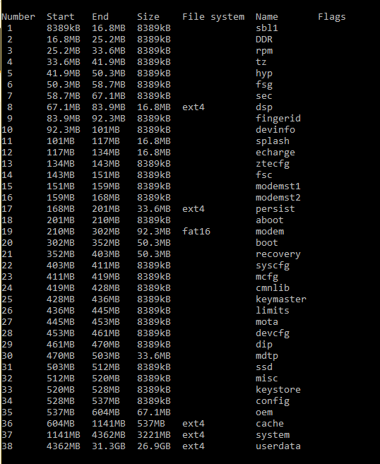

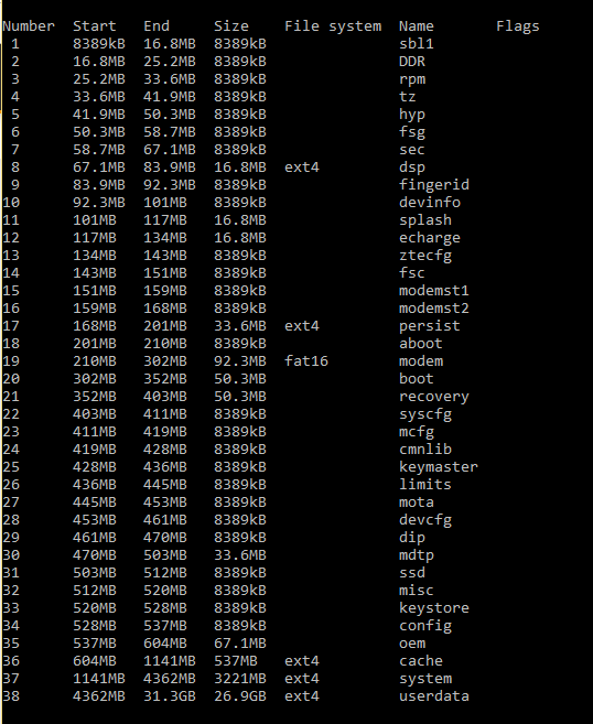

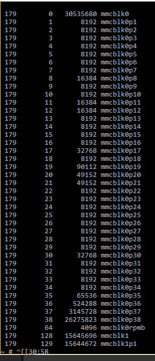

It gave this, but maybe this is more useful.
  • bootdevice_byname.txt
