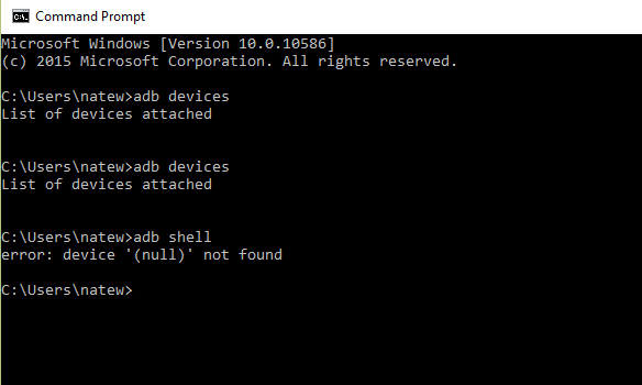

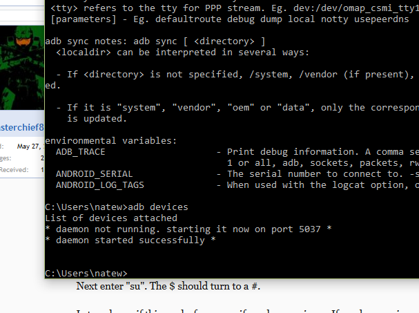

no serial number came up this is what i got:
nothing...
EDIT: i tried plugging in my working ZTE Avid (T-Mobile) and running the adb devices cmd, with the same exact result. the Avid is not rooted, so i wonder if that could be the issue here, could i have somehow lost ROOT on the Zmax? Making it so the custom ROM is incapable of loading? IDK I'm stumped on this one...
