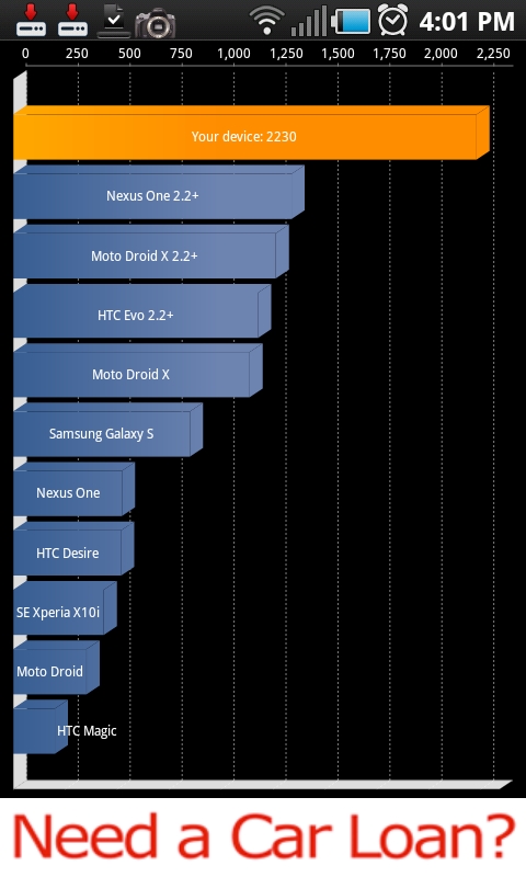

I am a pretty low tech newbie. I got my android device in August 2010. Here is a picture of my Samsung Captivate's benchmark after using RyanZA's OCLF. I used his program to Root my Captivate, get Superuser Permission, install EXT2Tools, Busybox, and OneClickLagFix V2.2 (using bind mounts). Everything worked perfect for me the first time through. I did take my time to read everything I could very carefully before stepping through this magic portal. Frankly, I must say is was very easy (and very exciting). The results are awesome!
After rooting and using RyanZA's OCLF, I aquired Root Explorer, Titanium Backup, SQLite Editor, Terminal Emulator, and ROM Manager. I can now download apps directly to my Captivate from a variety web sources. I never used a computer to do any of this, and I never use a computer to sideload apps.

Thanks. That is a easy process. My benchmark is 2340, which used to be about 900. That is crazy.
Caring about Quadrant scores when using a lag fix is "crazy" since they are artificially-inflated. The way the laghacks work throw the measurements out of whack and they become meaningless and have no actual proportional relation to the new performance speed of the device.
It's like throwing your car into neutral, stepping on the gas, and thinking 4000 RPMs means you're going crazy fast...
