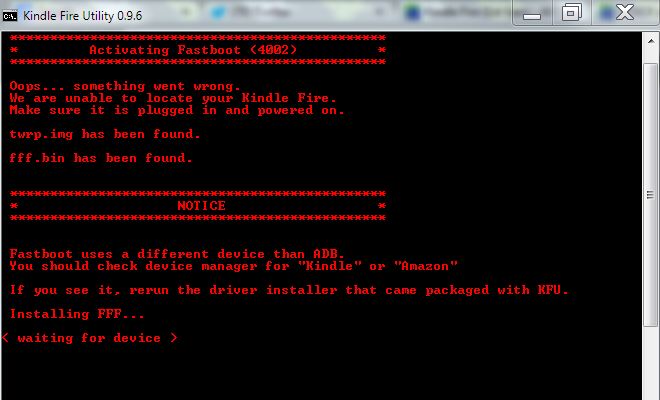

I am currently stuck at this screen trying to root my Kf via the Kindle fire Utilty and I'm getting no where. Yes, I'm a noob when it comes to doing ANYTHING to this device, but as far rooting goes for phones themselves im pretty good, just this tablet has me stumped, so if I could get placed at step 1, and get properly guided from there, that'd be nice please.
P.S. This KF is running 6.3.1, idk if thats a big deal or not, and it is freshly factory resetted.
Turn off the kindle, start up KFU and then while it is looking for the kindle plug the device in. It will turn on automatically and KFU should find it easily. I had a couple of problems when I first tried to do mine of plugging it in and not being found, after that it's as simple as following the on screen instructions.
