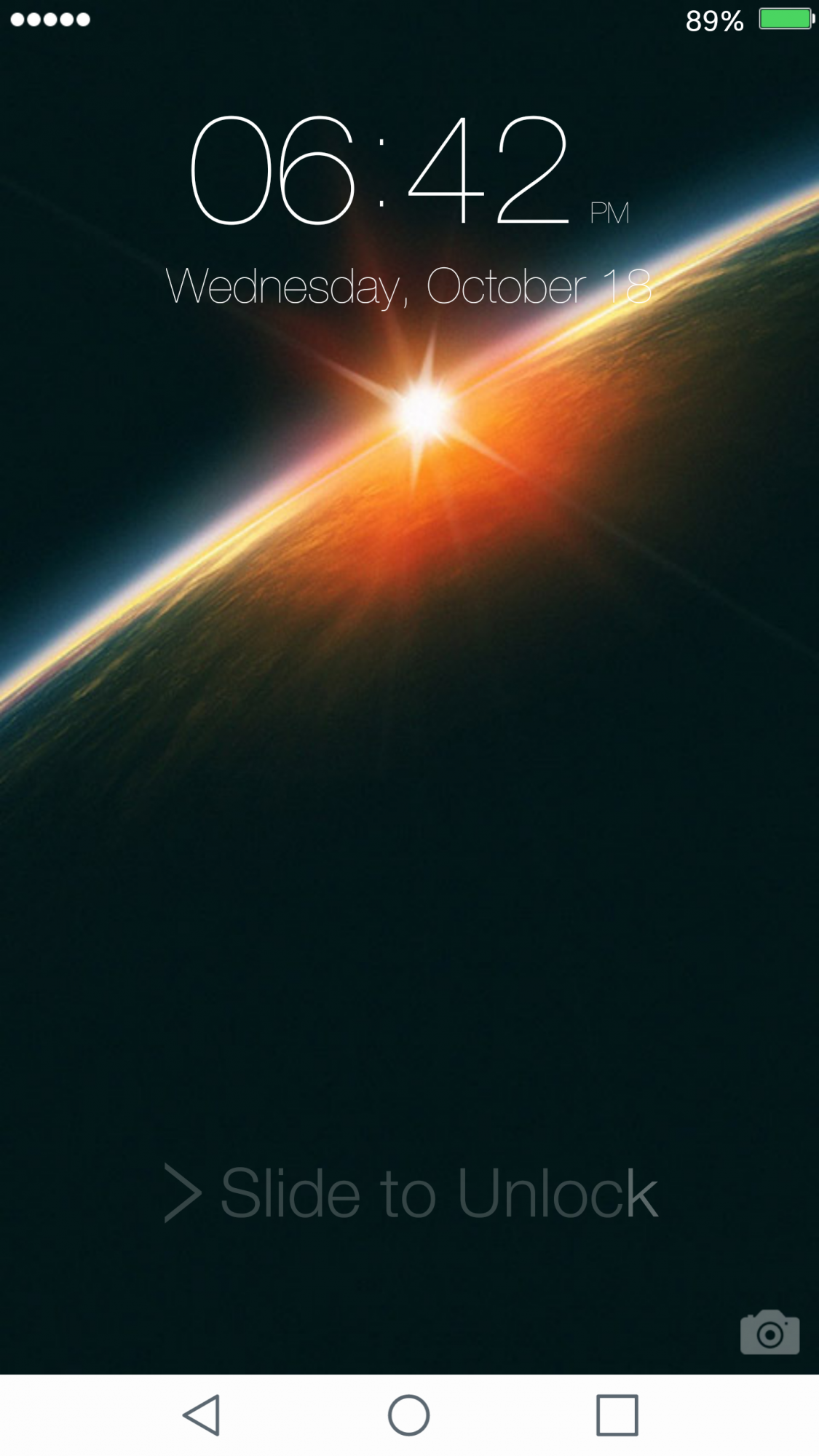

I have seen several threads relating to this topic but unfortunately most seem to relate to the peel remote. Unfortunately this is not the issue for me because I have long ago disabled and removed the peel remote and have not any issues with it. I have included a picture below of the the screen that pops up. It is extremely annoying and I cannot seem to find how it got there or how to uninstall it and would really appreciate any help. Thank you!!
I'm a little confused about your issue. That just looks like your lock screen. What is out of the ordinary about it?
Based off of your thread title, do you mean that you have two lockscreens? As in you unlock this one and then it takes you to the main device lockscreen rather than just Unlocking the device when swiping?
That is correct I have a second lock screen that is what I took a picture of. I have an LG v20 which uses my fingerprint as my unlock, and after I unlock with my fingerprint that screenshot shows up which forces me to slide to unlock.
Okay, this is clearly coming from an app you have installed that has it's own lockscreen.
Just need to figure out which one. Any suspicions?
Do you by chance have a custom launcher installed? If so, look in your launcher settings and disable the lockscreen if you'd prefer to use the stock lockscreen.
I'm using Nova Launcher Pro. I've never had an issue like this before and not really sure where the lock screen setting is but going to try and look.
It's possible it's not coming from Nova. A custom launcher was just my first thought. But it's most likely coming from one of your installed apps.

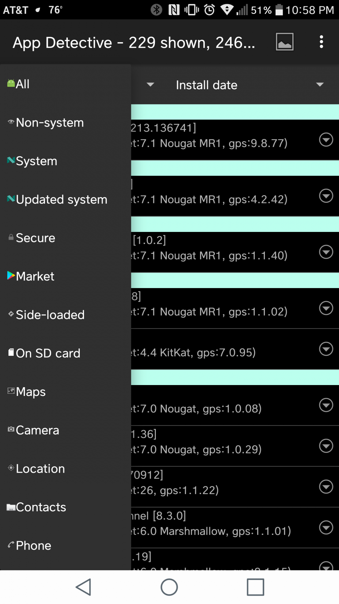

Also, you could install app detective:
https://play.google.com/store/apps/details?id=com.zmarties.detective
Let's you view all installed apps and order them in many different ways. Also has an option in the 3 dot menu to share, which copies a list of the apps to your clipboard.
So you could set it to show user apps only and arrange by date installed. Then share and paste the list here. Someone might recognize the culprit or it might just help to get more eyes on your apps to see if we can figure it out.
So I restarted didn't stay safe mode and the issue didn't appear. Unfortunately when I restarted even as I was trying to type this message the screen actually cut off my typing and went to the slide to open lockscreen. I downloaded the app you recommended I just don't see the user only option when trying to list the apps.
I had trouble understanding that last message. Are you saying that the issue was gone in safe mode?
Oh and sorry about that. "Non-system" is the option I was referring to.
And then in the other drop-down you can choose install date.
And in the upper right you can choose share if you'd like to copy the list and paste here.

I just downloaded that today though and I have historically use that and never had a problem with it.happy to remove it I just thought it might find an issue for me.
Well, if you know it's not a problem you don't have to uninstall it. It's just that there's many posts around the forums with those types of apps being problems.
I see something called sleep unlock. What is that?
Edit: nevermind, j think it's just the pro key for sleep like Android.
It's so hard to read these the way the forum breaks the formatting. Honestly, other than CC cleaner I'm not seeing anything yet that jumps out.
You might start toward the top of the list and start installing one by one. Lock the screen between each uninstall and see if that's gone.
When did your issue start? If you know, you can try starting by uninstalling apps that are just installed at the time it started.
It is a sleep tracking app that I use that I have had for several months now. I didn't even realize it was there or know what it even does
Maybe you can post a couple of screenshots of the top several apps? Then we could see them grouped by date and it'd be easier to look at too. If you want. Or you can just start where you think is the best place on the list and get to uninstalling 1 by 1
This truly was the last app I downloaded, but have already deleted
Movies anywhere?
Do you know approximately when this lockscreen showed up? The dates might help narrow it down.
