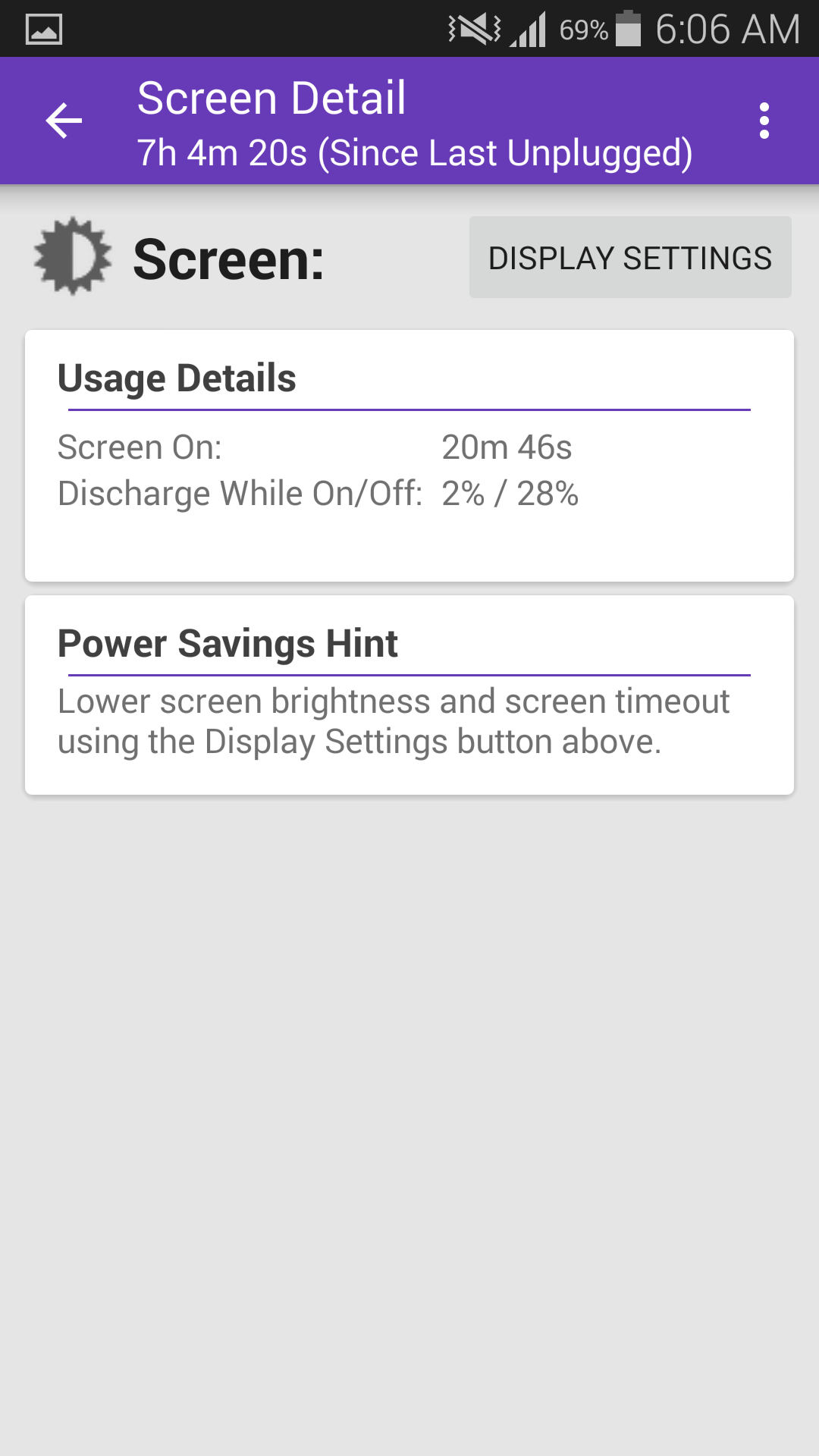

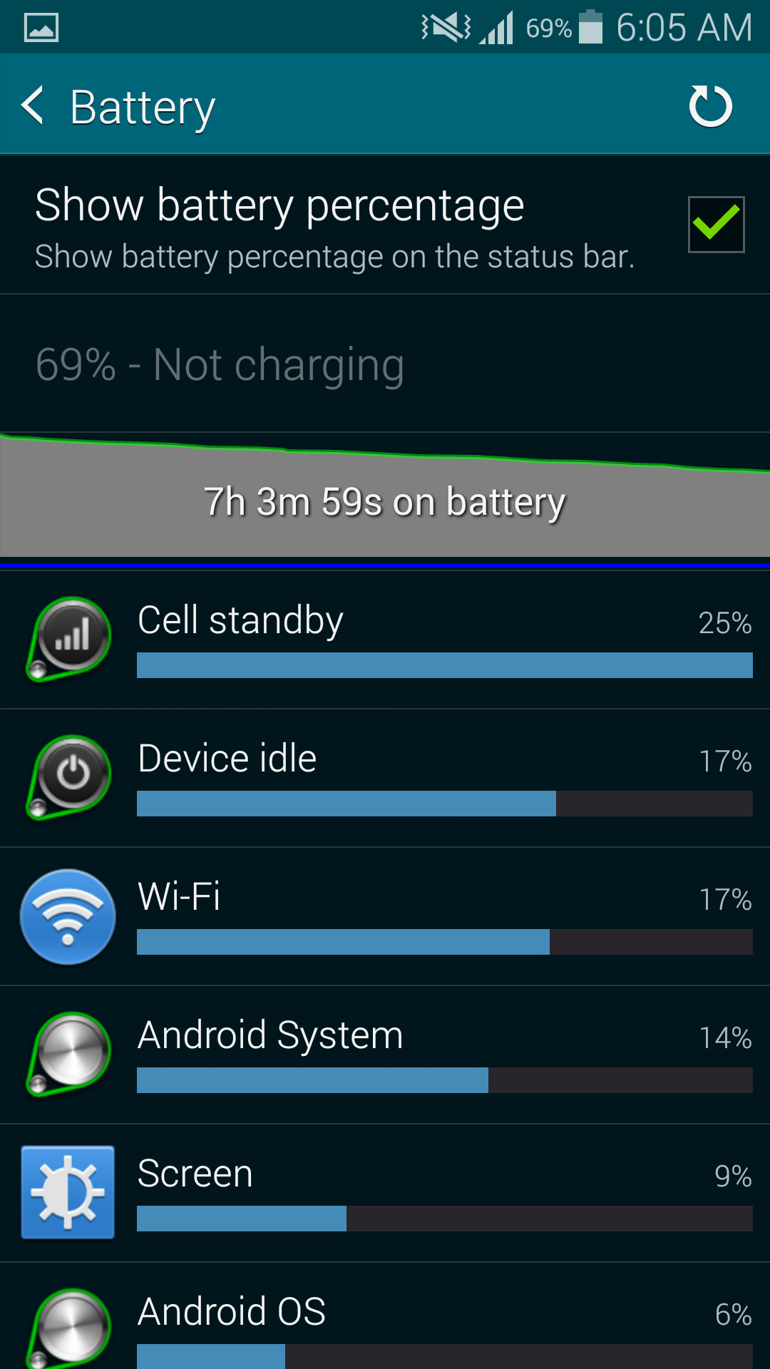

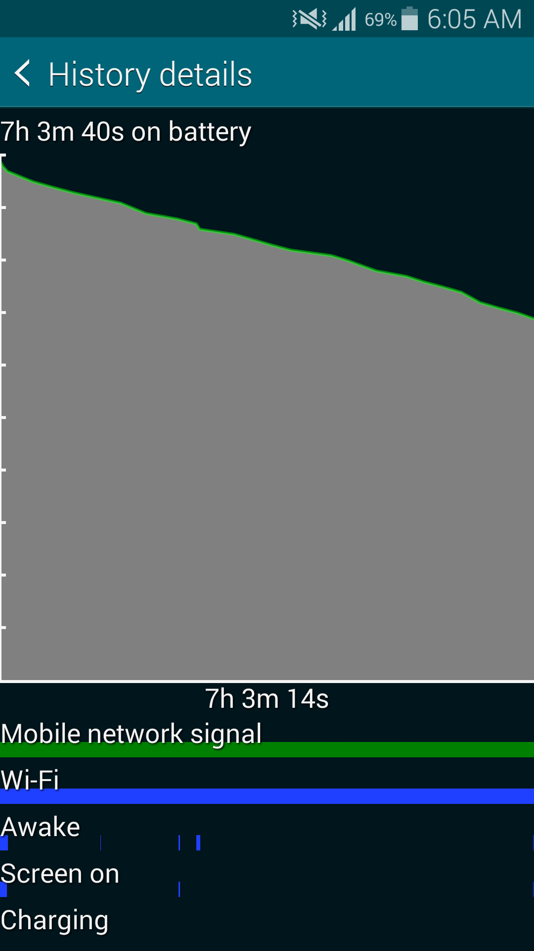

It shows that Phone radio and network are draining my batter (as shown in attached images)
Also how can screen brightness drain battery when kept idle screen locked mode overnight? (as shown in attached images)
Please Help.
I have attached screenshots when I found 69% battery remaining in the morning (kept at 100% at night)

You state it drains 30-40% overnight....as in, just over 7 hours it goes from 100% to 69%?
Your signal looks good, your awake time looks good, your screen on looks fine...
Honestly, it looks good to me :)

If data and WiFi are off I do think that's too much drain. But phone radio is only 24% of the power used, i.e. 7.5% out of 30%. It clear that the 20 minutes the screen was on were the main drain, and nothing was holding the phone awake. So it would have been good to tap on the app usage number in GSam to find out what apps were responsible.
BTW you say you tried data & WiFi off, but WiFi was clearly on during that test. If that's on then apps that want to use it will do so, so that must surely be contributing (indeed WiFi itself does show up as a drain here).

I suspect it may be that and I agree that sort of drain or even half that overnight is far too much.
GSam Battery Monitor - tap the Hoover at the bottom to get to the apps list (or the line that says app usage) - App power sucker screen - tap the top, view time held awake and number of times waking device.
If Android system is the big culprit, that's misleading - Facebook will beat your battery to death but everything it does gets assigned to the system.
So once you the time-based list, tap each app you're not sure about for details.
Wakelocks are easy to spot in GSam.
Graph, Others tab on far right, hold your phone in landscape (sideways) for better view. Zoom in or out as needed.
You should not have an active bar when the screen is off - just occasional blips for email syncing for example, same thing for GPS.
Your built-in power graph doesn't show any such problems.
Frankly - I don't trust it. I've been fooled by mine before.
By a little zooming in with the GSam graph, if you have a wakelock problem, it'll pop out visually - time that your graph is showing not active may instead show a lot of very short, constant wakeups.
See if that helps any.
And let's see your list of apps please from the time awake display in GSam.
We had someone within the last two days who traced his wifi turning on even though he did everything to turn it off to one of the security apps with a "find my phone" feature. Not sure which one - maybe Lookout? Anyway, check if you're using something like that.
