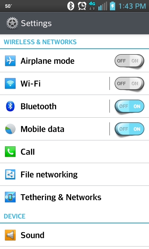

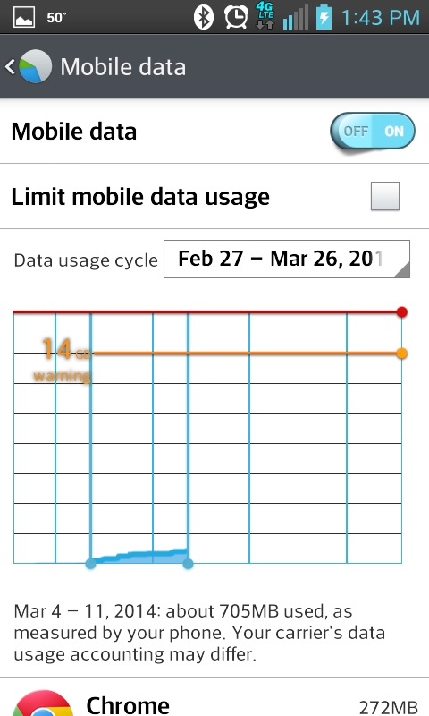

Here are screenshots of my screens. Settings, followed by the Mobile Data. There aren't any additional options.

No, I mean there is no EV option at all. Same thing happening on my wive's identical F3. There is no 3G option at all. It simply jumps from 4G to 2G.
