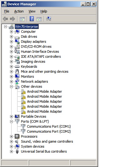

When I try to do this: On Phone Dial this code *#*#2846579#*#*
That doesn't work on my M835. Is it because of this that I can't get the drivers that Cybertails provided, to work with the detected devices in Win7 ?? I tried this also with WinXP and it won't take the drivers. I configured the phone for Debug mode and unmounted the SD card unmounted before connecting to the USB.
I attached a screenshot of what I see in my device manager for visualization.
Try this and see if it works: Downloads - Huawei Device Co., Ltd..
