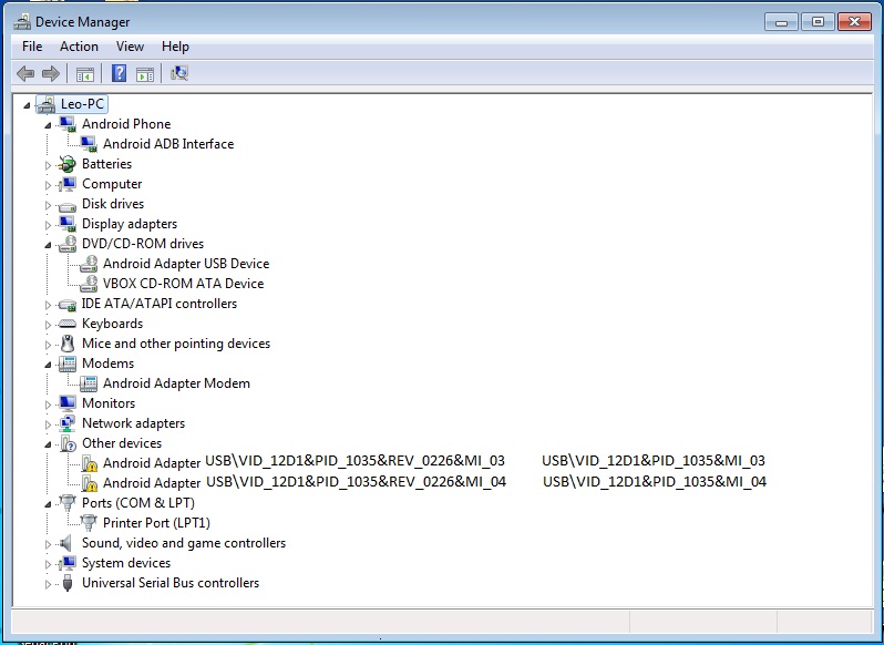

Yep, it was becasuse of CM7 I would enter the code and nothing would happen. So anyway, I set it to Manufacturer mode and installed those USB drivers from their site, still can't get the ports to be recognized in neither Win7 or WinXP. I keep getting 4 Android Adapter under "Other devices" in Device Manager in both XP and WIn7. I try manually updated the driver and pointing them to the M835 USB driver folder that you gave me first and won't recognize it. Also tried pointing it to ADB driver folder that's on the phone itself and won't take that either. I'm stumped.
Put the phone in manufacture mode, usb debugging, and unmounted the sdcard. I tried installing the driver on the phone, the one cybertail posted, the modemdriver, handheld android device driver from the huawei site, everything. All that shows up on win7 and winxp is the modem driver, not the com port. And I have 4 android adapters on there that can't be recognized. I tried manually pointing them to each driver but none work...
Strange, for when you have the phone plugged in, can to go to the device manager, right-click one of the Unknown Devices from the phone, select Properties, go to Details and Ctrl+C the Hardware ID? :)
This is a screenshot of my device manager with the android-related devices expanded. The "unkown" devices with no drivers have their hardware ids (each has two) pasted next to them.

Another thing; the Android Modem that's on there is port COM5, found that out by looking through the properties on it. Whenever I connect with CDMA Workshop, it says connected, but the phone stops saying "USB connected" and "USB debugging connected." Then I click "Read" and it says phone does not answer.
Then I can't connect my phone to my pc anymore unless I restart my computer. The same thing happens if I use QPST, and using LGNPST just doesn't work.

Hey, guys. I'm trying to get the drivers installed that CyberTails linked a while back (M835ModemDriver.zip). But I have a problem. After installing, on the last screen, I get:
The drivers for this device are not installed. (Code 28)
Driver is not intended for this platform.
I'm running Win7HP 64. I'm wondering if it's that these drivers are 32 and my system is 64.
Any help would be appreciated.
EDIT: Never mind, I got it. Now to flash this phone to Cricket!

What exactly did you do? I also have Win7 64 and got the same error...
Sorry it took so long for me to reply. Been busy with work and a way to flash my M835 to Cricket since I no longer live in a MetroPCS service area.
If CyberTails drivers don't work (they didn't for me), the ones I have might. These are for Windows 7 64-bit. I tried them on an XP Pro 32-bit system at work and it was obviously a no-go.
After diligent searching on teh Interwebz with many, many dead ends, a site called DriverMax claimed to have the drivers. They did require that I download their program to obtain the drivers. Anywho, I installed the program, then the drivers, and it worked. I'm able to use CMDA Workshop and QPST successfully.
I would add that you manually delete any other drivers or use something like CCLeaner to remove any previously installed drivers you tried from this thread, then install.
