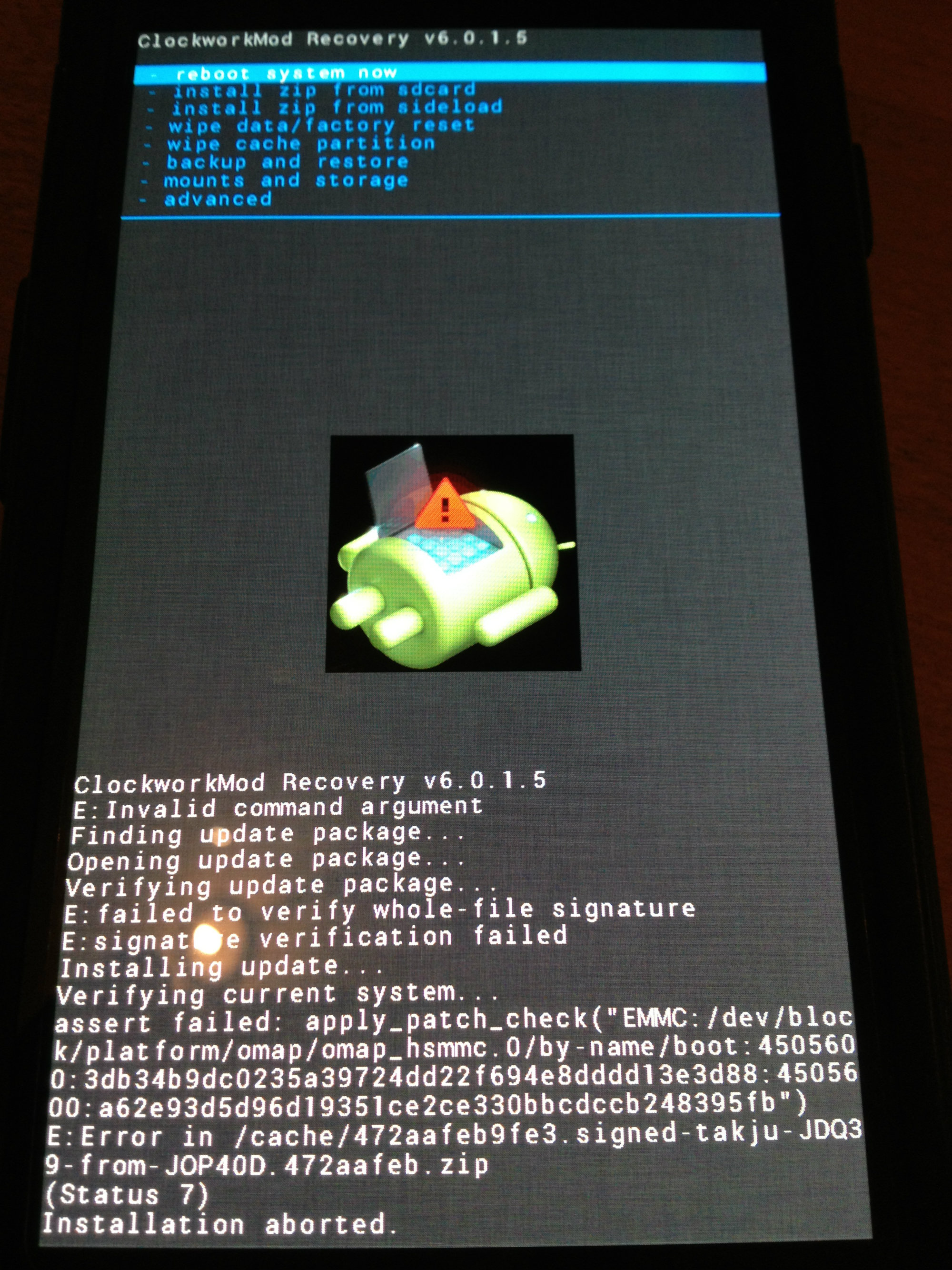

Got the notification on the weekend that 4.2.2 was available on my stock rom, rooted Gnex. Started the install and when I got to CWM and said yes to installing an unsigned zip, then I got the error shown in the attached image.

Trying to install an ota file with custom recovery installed on the device will usually fail on nexus devices because part of the ota file is to patch the stock recovery. The two ways to get around this is to either re-install the stock 4.2.1 recovery, fastboot boot into cwm and flash the ota, or flash a factory image.
