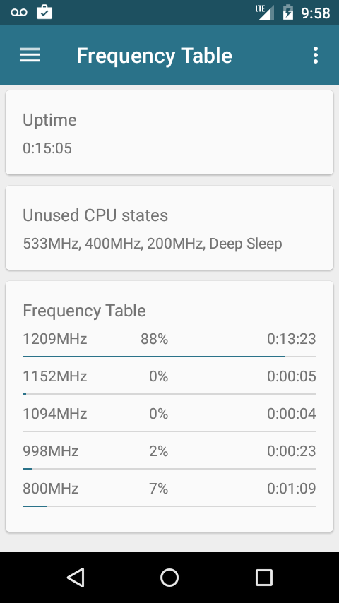

I was able to make it go down to 300 when I'm not using screen. Just open kernel auditor and go to CPU set it to powersave and set minimum to lowest and reboot
That didn't work either. They reset to their original settings as soon as the CPU upscales. I'm gonna reflash and go with a full wipe (sd included) it's fixed a couple of my problems before.

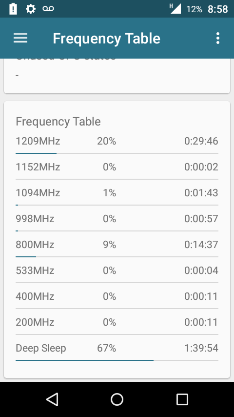

Scripts still don't work, but I've got core control. Turn off in app battery profiles before setting it to power save. The CPU will scale properly and it doesn't lead to excessive lag.

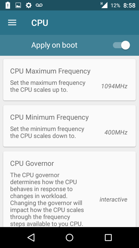

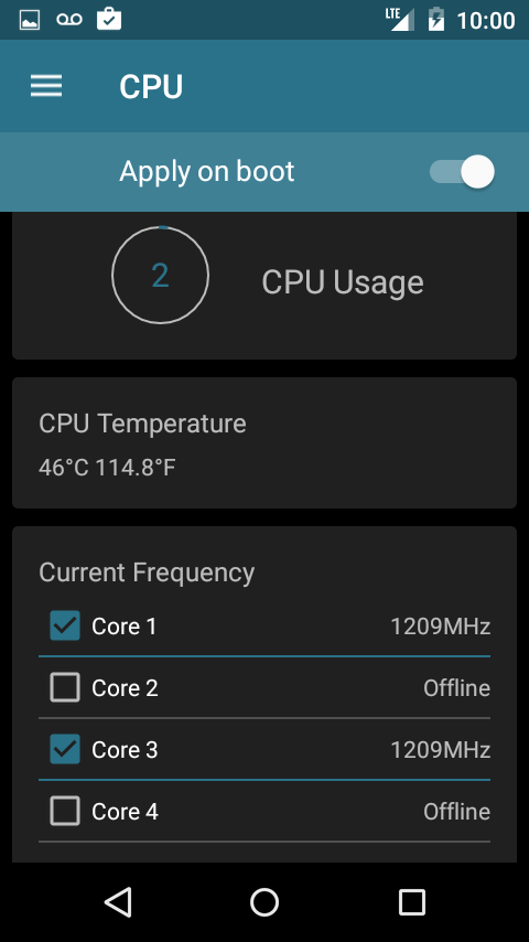

Use the battery saver and then plug in your charge cord. The CPU will scale normally and within safe levels.

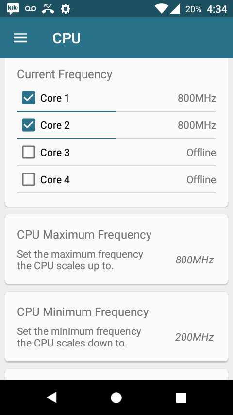

That's when you plug in your charger wire. It disables battery saver while tricking the governed intp applying changes you've made.
I've had two of the cores disabled and maxed out at 800mhz without suffering immense lag.
The battery saver is just the middle man to actually get your changes to stick in kernel auditor.
As another note, set the governer before you plug your wire in. Once the wire is plugged in, the CPU speeds will stay stuck at that rate until you change out of power saver mode.
