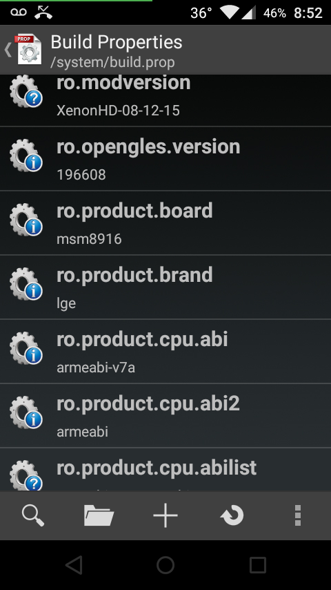

Build prop needs to be edited camera refused to work without edit have to edit the board line to metro like so
