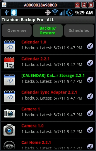

See attached.
You should have those calendar services.

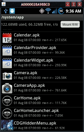

See Attached
You should also have these calendar .apk's
If you are missing the Calendar.apk you could try a couple of methods to install it.
1. Have a copy of Calendar.apk on your sdcard. Now use Root Explorer to navigate to the sd card and copy it to your clipboard.
Then navigate to the root of your phone and go to system/app and then hit Mount R/W to change it to Mount R/O and paste Calendar.apk in there.
Now tap Calendar.apk and select install.
Reboot and see if things are back to normal.
2. Use ADB to install Calendar.apk. Here's a good tutorial on how to do that. Installing .apk from a PC using adb
