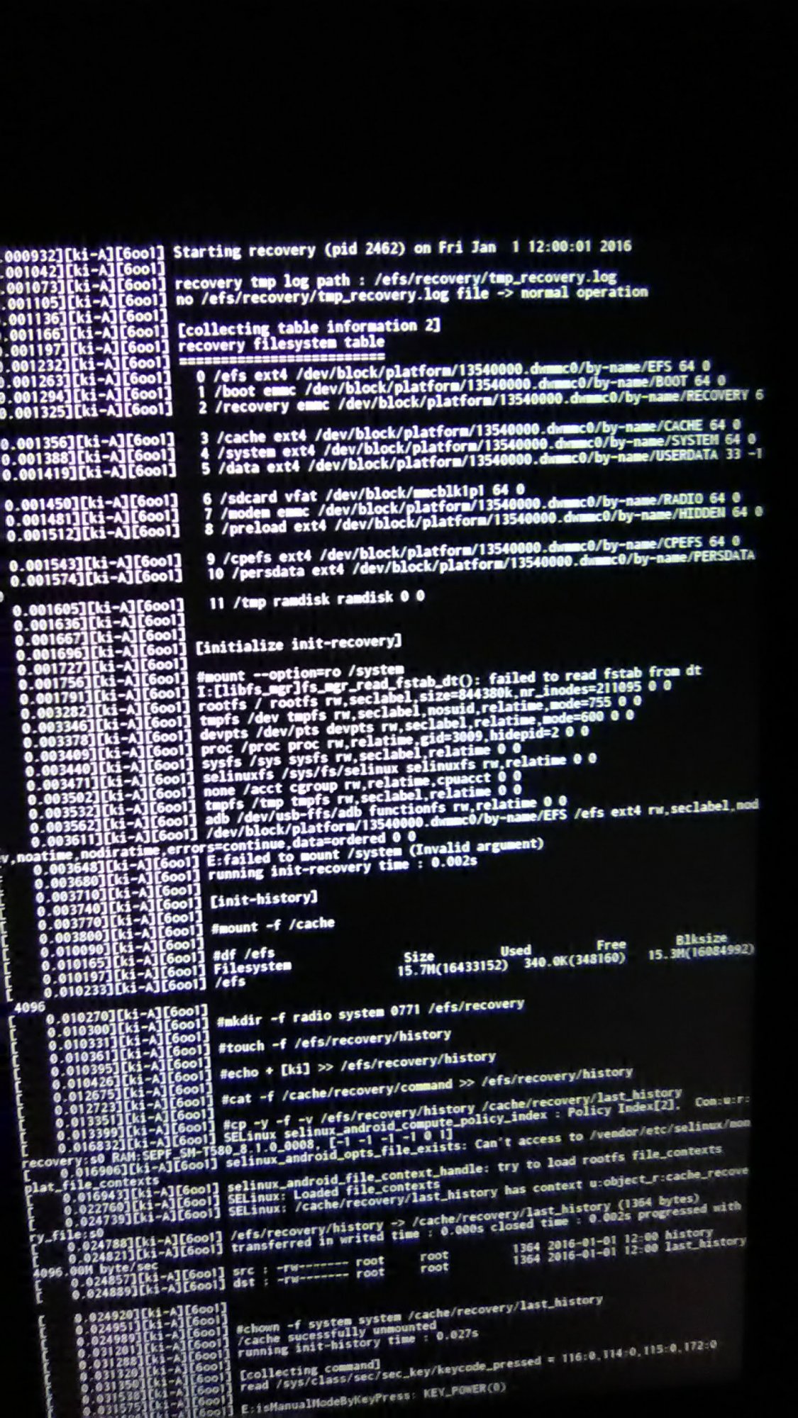

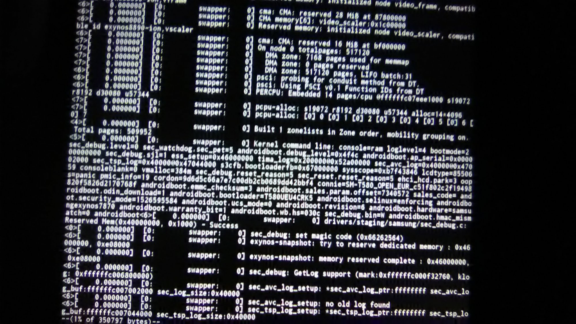

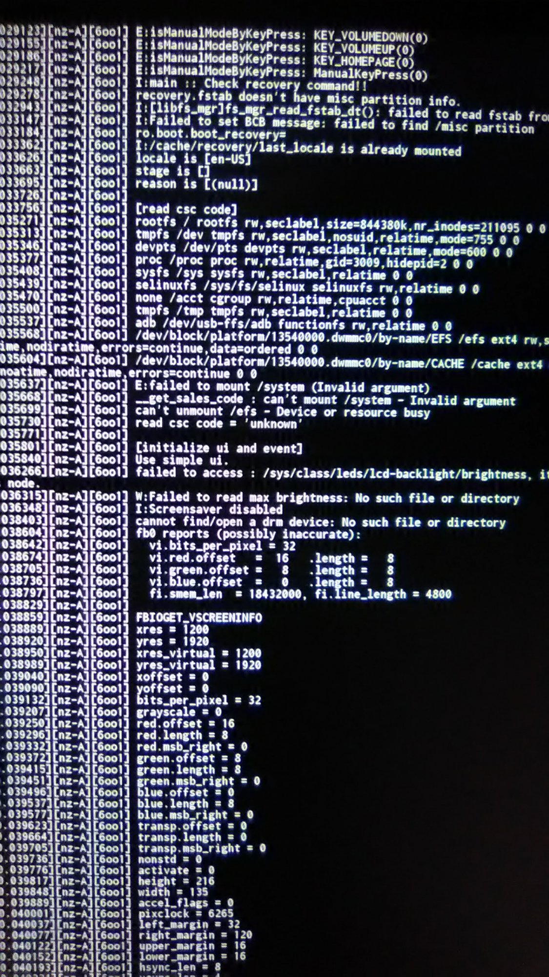

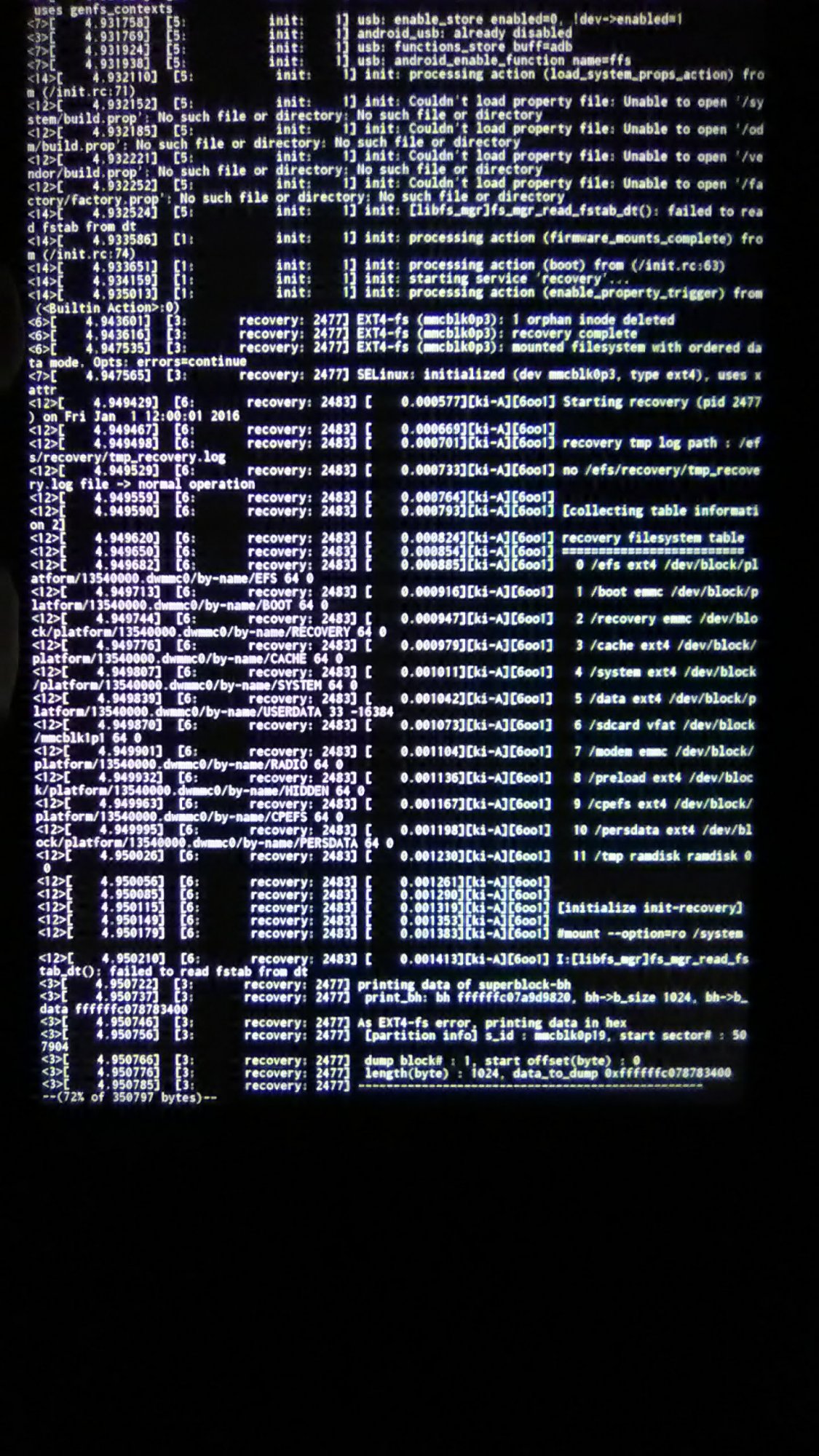

Heres a few screenshots, probably not very helpful, but eh...cant hurt

Currently when I turn it on I get these choices in recovery:
Reboot
Reboot Downloader
Apply Update from adb
Apply update from SD
Factory Reset
Wipe cache/data
Mount/System
Graphics Test
Lacking storage boot (or something like that)
Power off
#failed to open recovery, cause (No such file or directory)#
#Reboot Recovery Cause is [UNKNOWN]
No Support SINGLE-SKU
File based OTA
E: failed to mount /efs (Invalid argument)
Supported API: 3
E: unknown volume for path [/odm]
E: unknown volume for path [/vendor]
dm-verity verification failed....
E: failed to mount /cache (Invalid argument)
E: failed to mount /system (Invalid argument)
E: Can't mount /cache/recovery/last_locale
Lets see, what else....tried to run the graphics test. That came up with the image of the dead android robot saying error, then it erased something. I don't know what.
The low storage booting got me a lit up screen that said nothing.
If i try and let it boot by itself...I get the Samsung Galaxy screen and then it goes to that really bright yet empty screen and stays there. This I found drains the battery VERY fast. I do believe that I have exhausted every option to revive my electronic buddy. My new one will be here by Monday.
