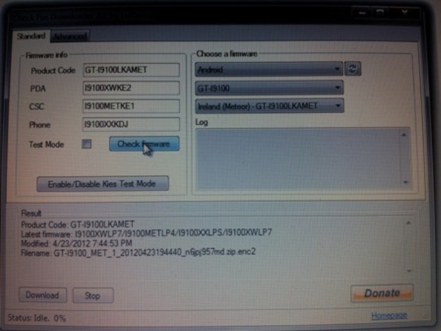

Did you make sure everything you selected is right? Also did you hit "check firmware"?
Can you post a screen shot or give me your info and I can see what it does when I input those settings?

Try this link for the checkfus download. I know it is a good link because its what I used to check your info.
When I try it here i input
Android
I9100
Ireland/Meteor
Here was the result
Product Code: GT-I9100LKAMET
Latest firmware: I9100XWLP7/I9100METLP4/I9100XXLPS/I9100XWLP7
Modified: 4/23/2012 7:44:53 PM
Filename: GT-I9100_MET_1_20120423194440_n6jpj957md.zip.enc2
With a download link below it.
But remove your battery cover and check to make sure what the exact model of your phone is. But this was the result I got....

wlp7 is the current firmare from my network accoring to check fus yes?
That's what it said......I have a picture posted, make sure all the inputted information is correct to your device.
Yeah so I didn't get quite the same results as you did in your picture though I entered the same information. The phone is definitely a gt-i9100 and I'm definitely meteor. Should I go ahead and root with Odin using the file I've downloaded? There was an official ICS update out so I figure I'll just use KIES to upgrade and then worry about flashing checkrom v7 at another time.
