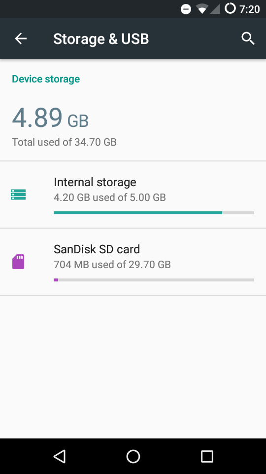

I'm now not sure that MTP has anything to do with my problem -- the difficulty in accessing the SD card that way is just a symptom. The real problem seems to be that after (logically) ejecting the card and then reformatting it as internal storage, it doesn't become internal storage. I'm uploading a screenshot that shows internal storage and the SD card, and they are two separate items even though I tried to use the SD card as additional internal storage. What am I missing?

The way I read that is your original Device (Internal) storage (5.0GB) and your SD card now installed as Internal storage (29.7GB) form a total Device (Internal) storage of 34.7GB, which is as it should be, albeit consisting of two physically separate memory areas which they are, but to the device it is 'Device (Internal) storage', of which 4.89GB is in use leaving 29.81Gb available.
The way I read that is your original Device (Internal) storage (5.0GB) and your SD card now installed as Internal storage (29.7GB) form a total Device (Internal) storage of 34.7GB, which is as it should be[...]
Correctomundo, sir! :D
Even under the adoptive storage paradigm individual volumes are identified discretely, albeit under the Device Storage label .

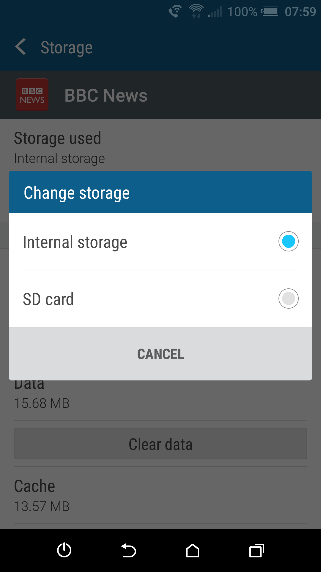

The question on my mind is whether it's possible to move any app to Portable SD Storage, or just those apps that have made provision for the move. If any app can be moved, that solves my problem, but it so far does not appear to be the case.

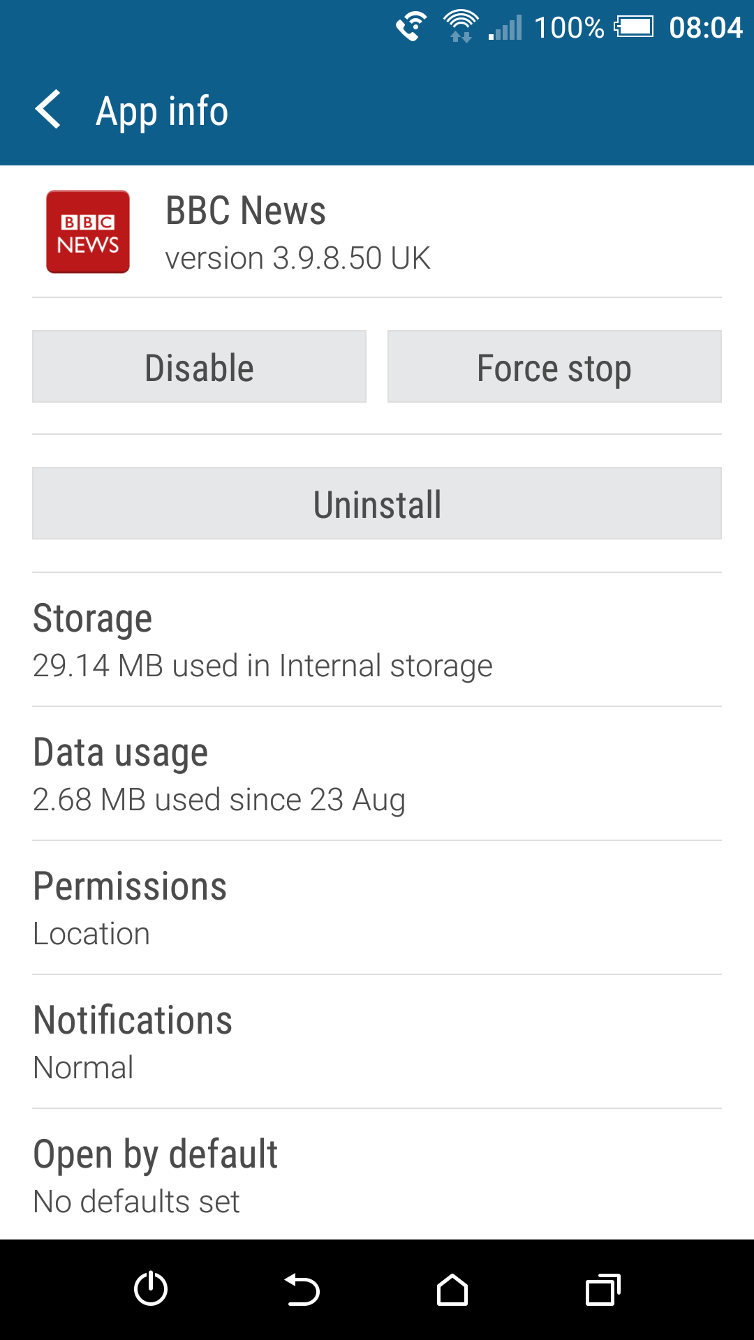

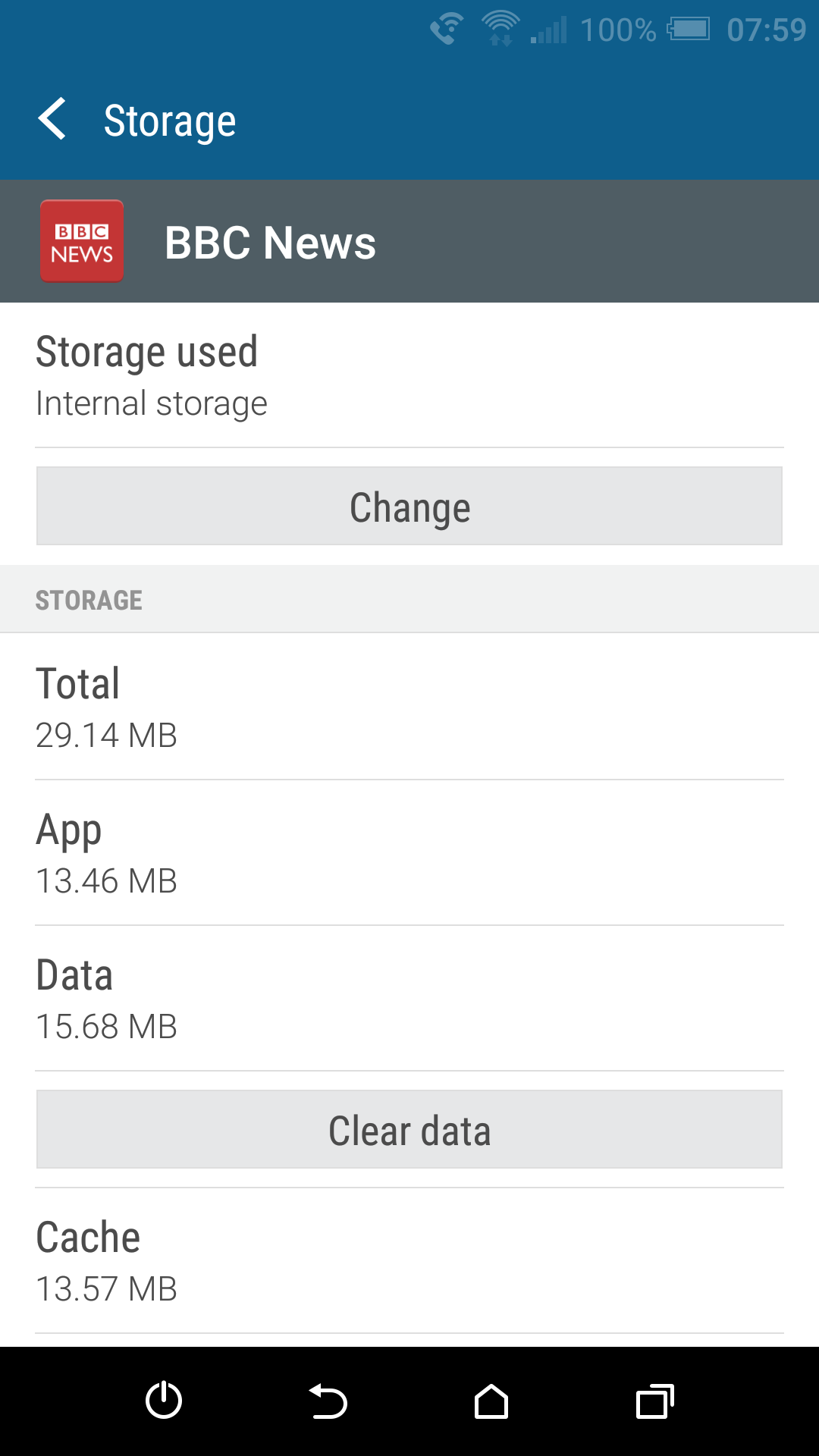

If you go into 'App info' and tap 'Storage', if you don't have a 'Change' option you can't move that app to SD card.

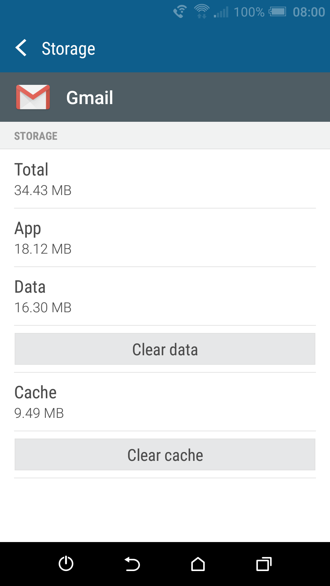

As Hadron said, and certainly on my M9, none of my system apps or pre-installed apps such as Gmail have the 'Change' option.
With some exceptions, one being 'Sky Go', any app I have downloaded from Play Store has the 'Change' option.
Screenshot_20161201-080411.png Screenshot_20161201-075941.png Screenshot_20161201-075959.png Screenshot_20161201-080050.png
