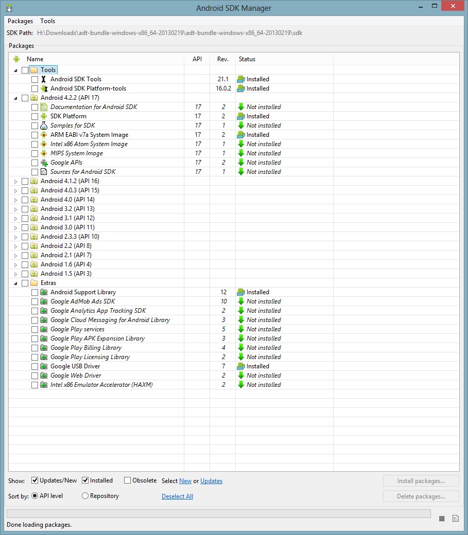

Hello, this is my first post. I am having a problem Rooting. The adb device is not found
running win 8 64 Pro
Android 4.2.2 on nexus 7
Nexus Root Toolkit v1.6.3
USB Debugging is Checked
Ran through the full Driver configuration tool uninstalling old drivers and usb drivers
Drivers installed using PDAnet also tried RAW Drivers afterwards
Tried several usb ports
Have unlocked the nexus 7 using manual boot
Using original usb cable. Usb 2.
no system mod regarding usb port
Can somebody help?
se attachments

I did it all manually but I do know that you need the latest adb inorder to get adb to work or adb devices will constantly show offline. Make sure you have the latest adb on your windows computer
wait you unlocked the boot loader? if so all you need is fastboot to flash the recovery.
I downloaded the latest SDK toolkit from this forum and moved the adb + 2 other files (can't remember at the moment) to my rootkit data directory, Still no sucess.

I have the same problem. When I run the Nexus Toolkit v1.6.4 my Nexus 7 v4.2.2. is not found. I tried several USB ports. No success.
Every time I run the Full Driver Test the I receive message ADB Device was not found.
I see the Android device in the Device Manager. When I disconnect I disappears, so the behavior is normal. DO I have to root the device? When I runt the backup under NRTK it even reboots the Nexus 7 but then after reboot the backup freezes up.
1. Nexus 7 v.4.2.2.
2. Win 8 64
3. Norton Internet Security 2013
4. Tried all proposed Driver solutions in NRTK v1.6.4. with no success.
4. Google ADB dated 8/27.2012 version 7.0.0.1 shows as working properly.
5. USB debugging enabled.

Are you perhaps using a USB 3.0 port? This causes trouble from time to time.
