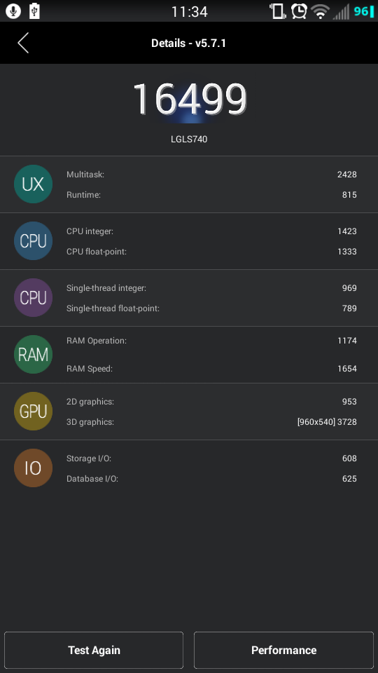

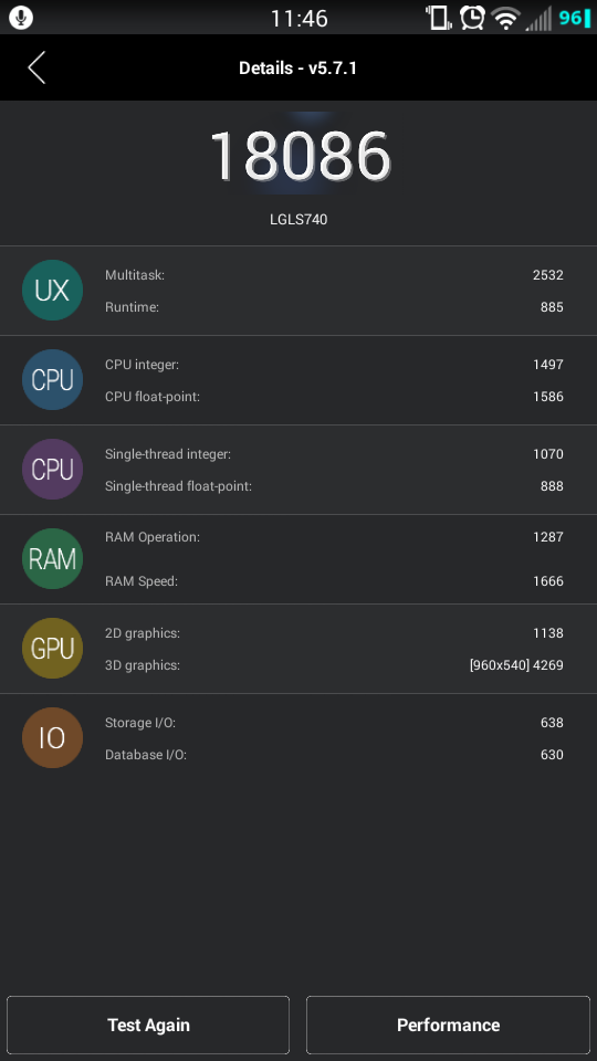

Ran Antutu a few times and took a screenshot on the second run results. I attached screenshots of the results, though I cant see a clear difference though. With the mod off I scored a bit higher overall eachtime, but it could just be random. Not sure Antutu is accurate enough to test the mod?

Anyone tested with benchmarks like Antutu. Is there a fair gain when using this?
****In order to get accurate results, we would have to have a baseline. From there testing would have to be done at each change of the system, every app and customization. Testing would need to be done over extended period, testing as stock and then modded.
Your scores shown in post 21 are going be different than what others will get, simply because nobody has their device setup the same. I've also never been a fan of the benchmark tests. IMO 9/10 they're inaccurate, plus random results.
But if someone does want to test according to the **** above, I will include them in the OP.

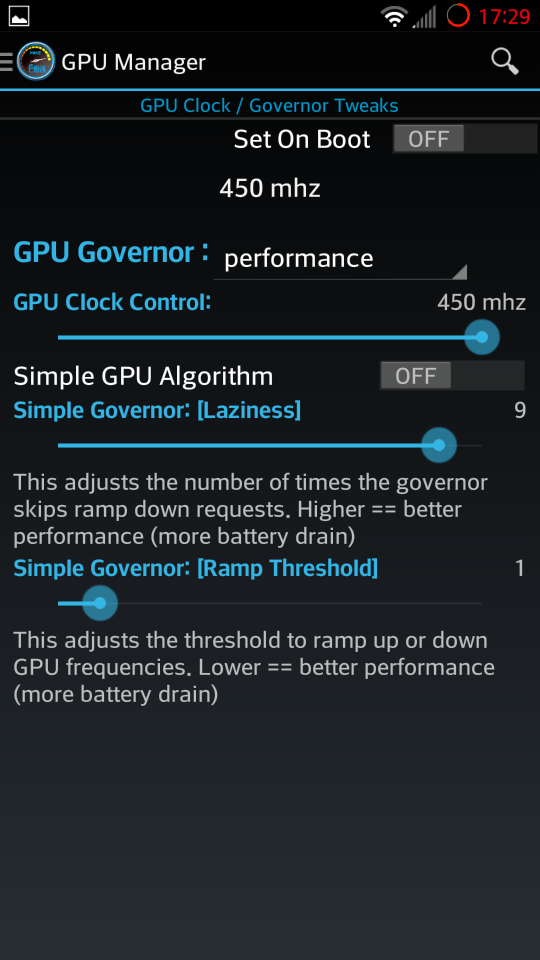

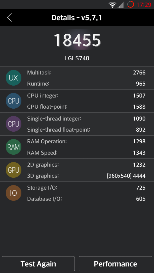

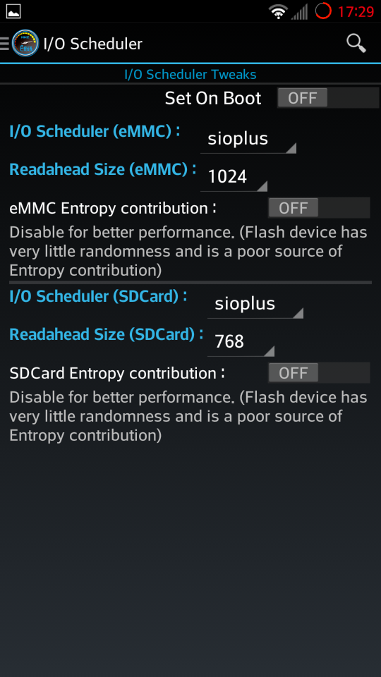

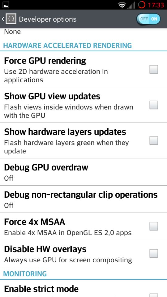

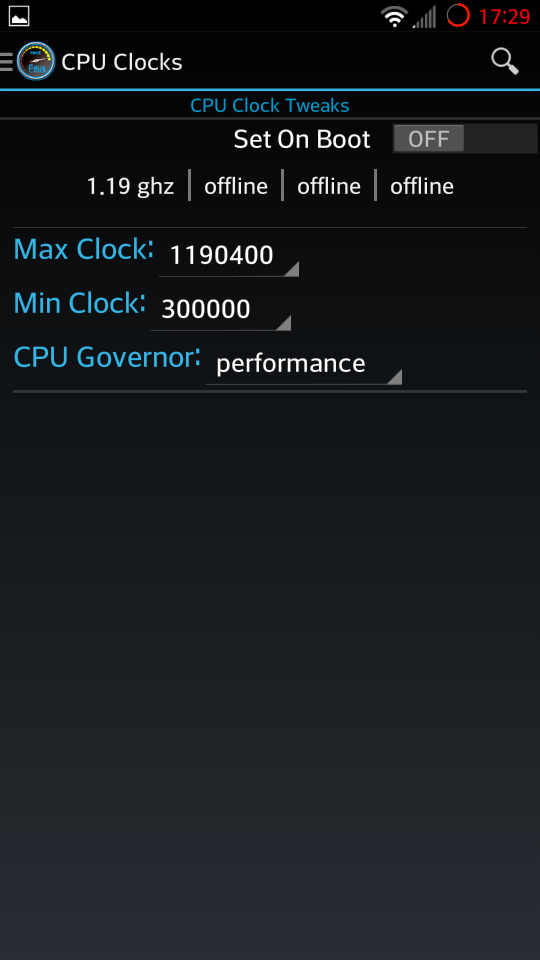

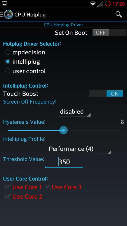

I flashed the Volt UNO kernel. Here are the settings I used, in attached photos, which I normally wouldnt have set as such (not the right settings for balance). Even with enabling GPU algorithm in photo 3, still maintained similar results.
Screenshot_2015-10-26-17-29-28.png Screenshot_2015-10-26-17-29-20.pngScreenshot_2015-10-26-17-29-37.png Screenshot_2015-10-26-17-29-44.png
And last screenshot will be from developer options
But thats what I had to tweak to get those numbers, with the mod in place.
@redspeed what do you have your settings at to achieve your results?
On the stock kernel I couldnt get any higher results than 15,000.
GPU benchmark 3D, seems the most consistent. All repeated tests were within a few points of each other. Here is results on the mod with kernel settings the same as my previous post.
View attachment 95967 View attachment 95966View attachment 95968 View attachment 95969

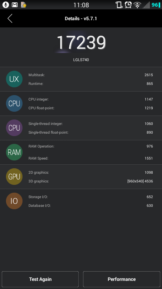

Everything is stock on zd6 I just debloated all the apps I could.
