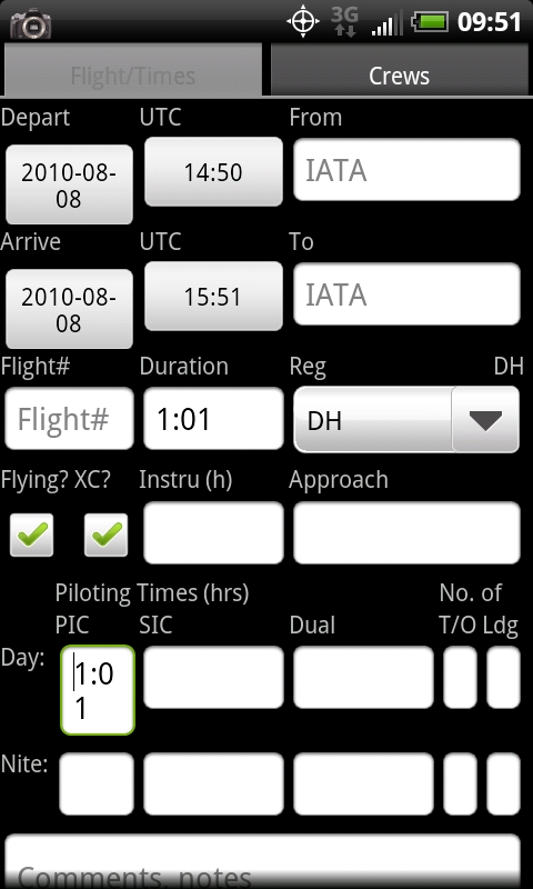

Some of the fields wrap the text on my EVO if I hold it verticle...

We're aware of this problem. In fact, this issue is documented in our product page. This happens with HTC Sense UI handsets, and it seems that the airport fields are assigned a very long field length, causing the other fields to be squeezed. Check the screenshots in our product page, and you can see how the screens should be rendered in stock Android.
We definitely need to fix this up before we hit v1.0.

I also noticed you may have changed some of the screen settings or something with the screen layout. It looks a lot better but there is still some tweeking to do... I'll attach a screen shot. The date and the PIC still wraps. I did just do an update on the EVO software, maybe they made some changes too?

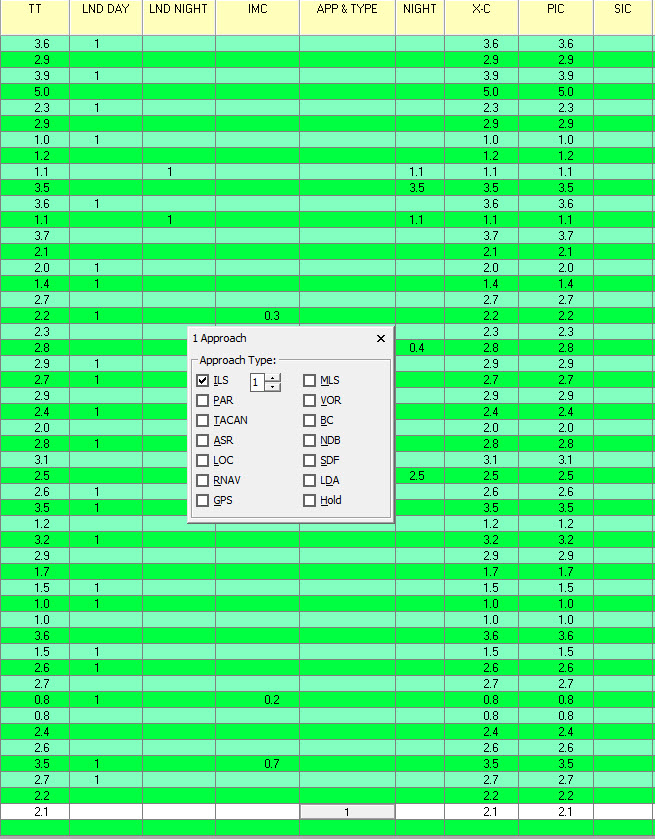

One more thing and I don't know if this is too much to ask. In the Approach box: Is there a way to make it a dropdown selection for the type of approach? I'll also attach a screen shot of Logbook Pro where they select the number and type of approach. Not sure how this would import to Logbook Pro, but I'm sure if anyone can figure it out you can!

Yes, we did make some changes to the screen layout hoping to fix the issues with Sense UI. It's a bit better now, but as you can see, some fields still wrap. I'm interested to see what Sense 2.2 (supposed to be out in the next few days) will bring.
Other pilots have also raised the approach request. We haven't decided what to do yet, but one possible solution is to add an extra tab to capture individual approach types (like LogBook Pro). Some pilots have told us that they don't log approaches at all.
. Is a dropdown box sufficent? That would be quite easy to implement, but you can only log one approach type per flight. Is this correct?
Since I use Logbook Pro, you can guess which way I would like it.
We'll keep the original text field as comments.Also, it would need to be reflected in the export file, each type of approach would have to have a column.

Had to re-enter 52 flights and 5 A/C types with 35 Registrations. Oh well, At least it wasn't too many.I finally did the upgrade to 2.2 and I can't tell any difference in the screen layout. (Screen shot attached)

Ok, at least they didn't mess it up further
