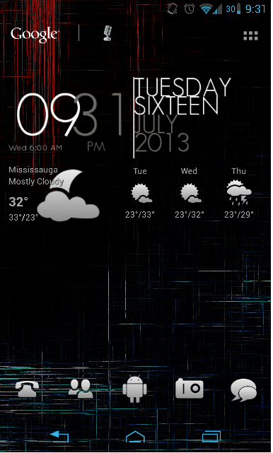

I want to know where the option is located in UCCW for showing the alarm. You can see what I have and where the time is on mine in my screenshot. I want to add the alarm under it after I've nudged everything up a bit.
I cannot find this setting when viewing the time in edit mode... can you tell me exactly where it is?
Ok. In edit mode, top left there is the +- button to add items. About 3/4 down the list you will see it. Right after "image" and "Gmail". You should see "Next Alarm Time".

I did, just a few minutes ago. Came here to let you know. It was right there in front of me, and I must of looked at it six times lol.
Thank you for taking the time to type out the steps to locate it!!!
