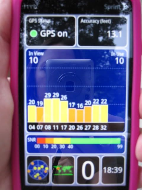

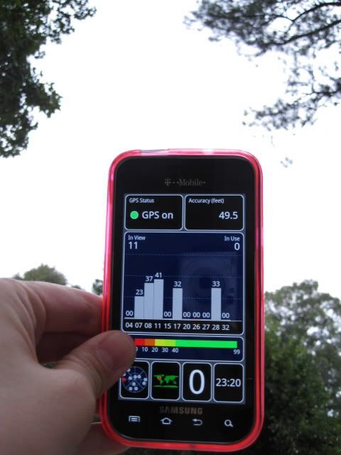

Today I brought home what some would say is the best phone out right now, the EVO. And guess what? It's already boxed up and ready to go back to the store. I SO wanted to love that phone. I thought I would. I thought it would solve everything. And it is a great phone. And I am keeping it overnight to think about it. But, I am not sold on it. Nope, not at all. I am addicted to this freaking vibrant. The screen KILLS the EVO screen in clarity and in color. I mean KILLS it. And I don't know if I can go back to a life without swype (it's missing on the EVO). I think we're all screwed. We're spoiled to this screen and may not ever be happy with anything less again.
I wanted to add, this is how screwed we are:
Vibrant outside:
EVO outside:
Together INSIDE:
And yes, I changed the case when I came inside. The bleeping pink case is too hard for me too press the buttons and the phone kept going to sleep while trying to get the pic. i put it back in its tmo case.
