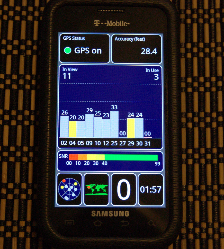

Odd, it's 6pm and as expected I now have 3 locked in 4, 29, 31. Hopefully some others can chime in here and post what they are seeing. It would help us to eliminate folks who have other problems as well as if it is affected greatly by time.
Here is a screenshot to show that I am in fact able to predict what will be locked in. :D
Edited to add: Sat 21 will be the next one to lock in at roughly 6:20 PM

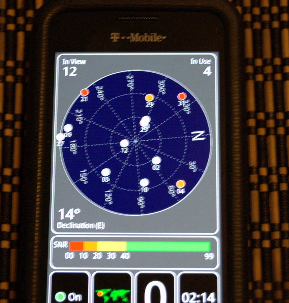

I figured I would create a new post again just so folks couldn't accuse me of editing the old ones to show what I wanted them to show. ;)
As you can see, 4 Locked. The 4 I said, 4,21,29,31.
In about 15 mins.. 29 will still be in view but will no longer be locked on.. Leaving 4,21,31 as the sats that are locked.
