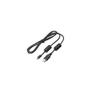

Looking through my supply of cables I have found micro USB plain, with one "barrel" on the micro end and one with "barrels" on both ends.
As I don't have my Desire yet I don't know if they will charge differently.
What are the differences?
What are the barrels for?
Thanks,
Shofar
Are you on about like on this cable:
They're just to give you something to hold onto when removing the cable aren't they?
