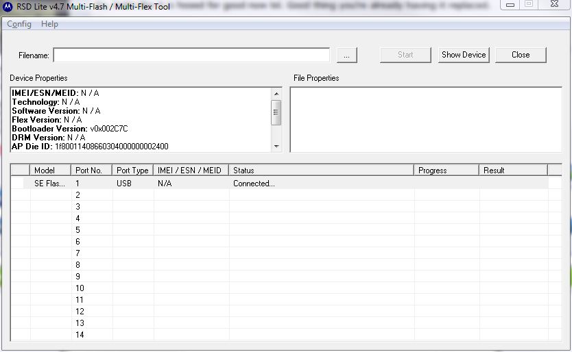

Here is what I see: RSDLite.JPG
And I timed it - when powering on it was literally less than 2 seconds before the bootloader screen was up.

ok, I removed battery and tried to go into bootloader again and I see that.
That's really weird about everyone getting blank screens.
OK, then you should be able to do it - did you download the right file?
Try downloading a different file (use the 2.0 stock to really pi...er, make them scratch their heads lol...)
If it is failing that fast, then your download may have been corrupt. I was thinking that it was not making it into the bootloader since we could not visually confirm it - but if you're seeing what I am seeing in the RSDLite program, then it is definitely making it into the bootloader.
Therefore, your phone is in bootloader (check) and RSDLite is working (check) - so it has to be the file.
