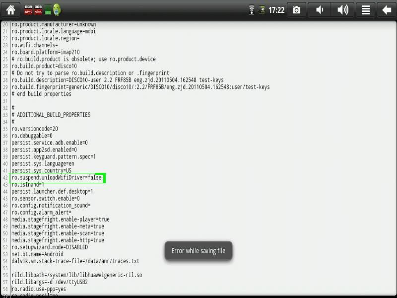

wireless certainly is disabled in sleep mode.....unless you change the build.prop file like this...
line 42 from
ro.suspend.unloadwifidriver=true
to
ro.suspend.unloadwifidriver=false
then it stays on to allow downloading whilst sleeping (at the expense of your battery charging!)
