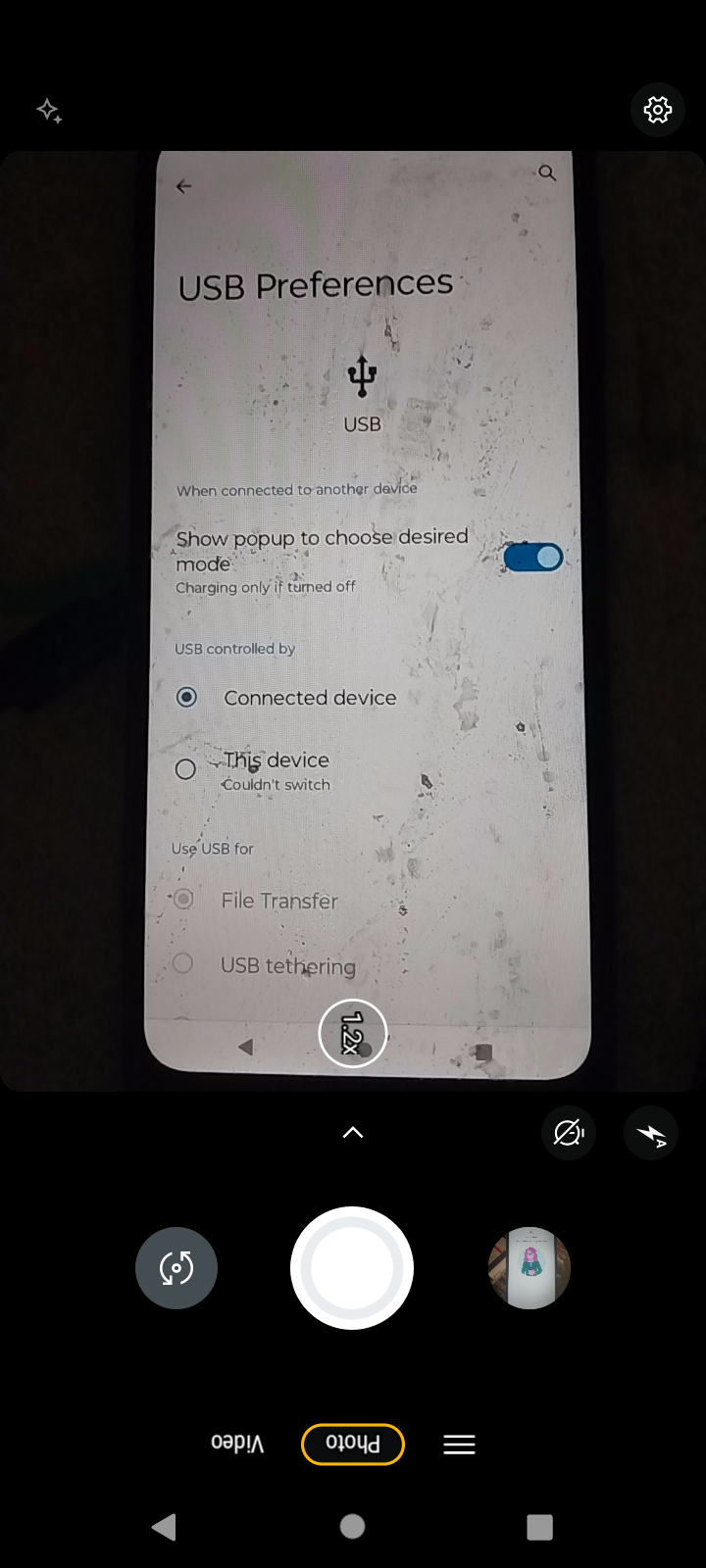

I'm pretty sure from what I've read elsewhere that it's the charging port. I tried using the grip end of a flosser and a little bit of dark crud came out of it. Ir's 4% now and I apparently have no choice but to shut off the piece of garbage, maybe forever. Perhaps a clue can be found in this screenshot of the Pure, taken with the obviously superior Play.
