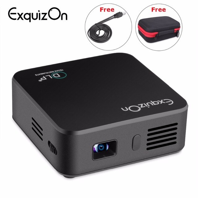

sir this device is E05 dlp mini projector and it have builtin battery yes i can remove battery and i have tested batter its working fi9 and even charge my battery on my external charger.
let me tell you one thing first. my original stock firmware got bad so try to find its original firmware online but its Chinese product so i can not find firmware online so i found same specs and same kernel ver and android ver other model projector firmware that is Toumei.C800.series. which is working on my projector booting and starting android but its not detecting charger and battery levels and so that shutting down android immediately with critical battery error. if i send u this firmware can u edit to make it work for me.

boss charger is connected and battery is new and its fully charged but firmware is not stock its from some other projector model i guess charger ic driver is not comparable with the hardware if some one knows how to update kernel file or charger file in boot.img of this firmware can fix my issue my charger ic is BQ25895

any one knows how to edit kernel.img or boot.img files coz i guess the boot or kernel is from C800 that projector have 7.2v battery and my projector have 3.6v battery thats why low voltage. and power button is also different i need to edit kenel.img file do any one know any tool to edit? and open files
