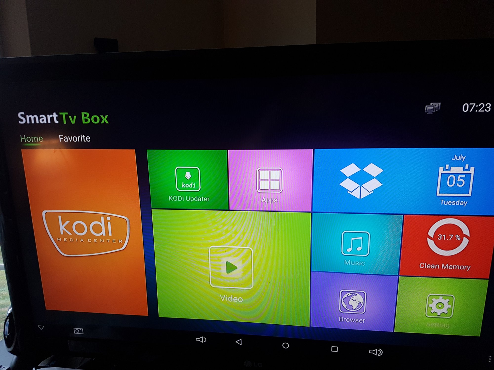

I am currently working on an Android Box. It is a Q-Box with Lollipop 5.1 on it.
The supplier that I purchased it from installed a Home Launcher called swin8launcher.
From what I can gather is that it is an in house custom home launcher that they have installed on the Android box. The home Launcher looks great in my opinion, but it would seem as though they have the configure options disabled completely. I am unable to enter any kind of "settings" to modify the buttons on the Home Screen. It would appear as though the box has been rooted, which is why I am posting this in here.
I am inquiring if there is a simple script somewhere that I can change that would enable the "change" features on this launcher. I mean they had to of configured those buttons with settings some how and I suspect that they just went in and added the various buttons and then locked it down. The main reason why I am asking is I am going to strip out all of the third party junk they have installed on the device which will make the majority of these buttons useless. Specifically the Kodi button in particular. When I take off the preinstalled Kodi and install the latest version, the Kodi button is no longer functional.
So my hope is that I can easily re-enable the modify functionality of this launcher and change it around to what I want. Fingers crossed someone can shed some light.
Also it would appear as though the system default launcher has been removed so I cannot change the launcher without first downloading a new one. So ultimately the end game is if I cant change the configuration files to do what I want. Plan B would be to download a Launcher that looks as close to this as possible.
Thanks in advance for anyone that can point me in the right direction.
Here is an example of what it looks like in case anyone was wanting to do some research on it.

Thanks for the help. I should have updated this thread sooner as it can be closed.
Unfortunately there is no resolution. I originally thought it was the distributors that bought the box from the company, went and made changes and customized it like most companies that sell these boxes do. But that is not the case. It is the actual manufacturer of the box that made this change and locked down the home launcher. They also removed the stock lollipop 5.1 home launcher as well. The coding that locks everything down is literally in the APK file.
I have a basic understanding of coding, but as for actually writing the code for a home launcher is WAY above my comprehension lol. So needless to say the only resolution is to go out and download an install a third party home launcher program and that will reset the home settings and let you make changes.
It is a shame really because I help a lot of friends and family with Android boxes and I was really impressed with the interface cause it made it so easy to navigate, while hiding the stuff that could get them into trouble lol.
I ended up choosing TVLauncher3 as the new home launcher. It is quite similar to the one that was originally on the box.
