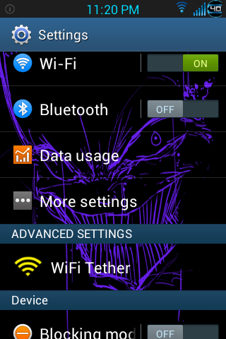

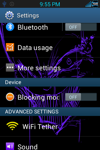

Yay! Progress!
The only downside is I had to use the stock sec settings.apk the one we were using was from teamblackout. It works 'as is' in the rom, but it seems that making changes breaks it. :confused:
(And yes I know the header is out of place... but its more proof of concept)
Nice job, do you know how hard this would be to do on say a pac man rom? Or Cyanogenmod?
I imagine it wouldn't be any harder than this was. If the format is the same it would essentially be the same exact process. If the format is different, you would just need to find the correct edits to make it function.
