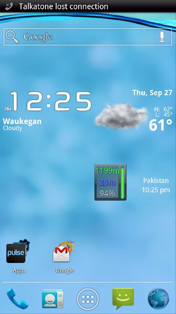

HTC 1.0 mAH charger and charge only cable, see battery monitor widget
