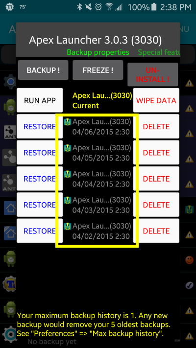

I have used Titanium Backup and made 3 backups of everything on my phone (apps , data, etc) . Backups have been verified to be on my SD card . I tried restoring a particular backup but can't figure out how . It automatically restores from one of the three backups that are on the SD card. Is there a way to specify restoration from a specific backup date/time ?
Thank you !
Samantha, you should see historical copies of backups like mine (depicted in yellow), *if* you have configured TiBu to keep X copies of backups (Menu - General - Preferences - Max backup history)
