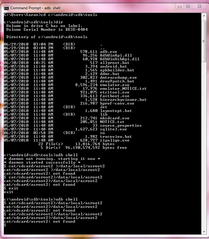

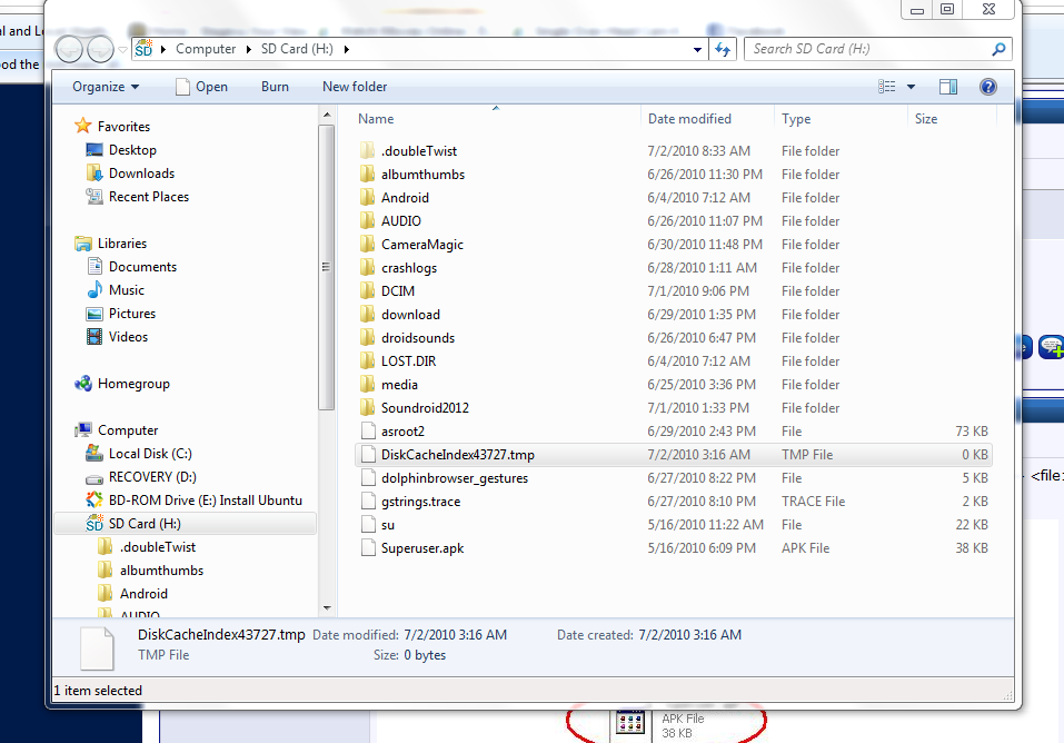

heres where im at
This will happen if you're still sharing the card with your computer. Like I said in my post, after you copy the files over to the sdcard, you have to eject the drive/phone from the windows box. The phone will not see the card if windows can see it. hence your "not found error".
just to be sure you're not sharing the card between the system and the phone, unplug the USB cable from the PC (after ejecting it), leave it out for a couple seconds and plug it back in. If windows tries to show you the contents of the card after plugging it back in, just eject it from windows and leave the phone connected then try to run the commands.
biggest thing to remember is that only one operating system will be able to mess with the sdcard at a time. Think of it like an external hard drive.
heres where im at
Gabriel.... you need a space between cat and /sdcard/asroot2. That's the problem you're seeing above. Without the space, the system thinks "cat" is a directory name, rather than a command. So type:
cat /sdcard/asroot2 > /data/local/asroot2
with those spaces. Maybe it's best to copy and paste it.
that was a big part of it
i replaced the spaces with underscores fro emphasis
cat_/sdcard/asroot2_>_/data/local/asroot2
WARNING the underscore is so u can see the spaces do not put them in the line of code
i am now rooted!!!
