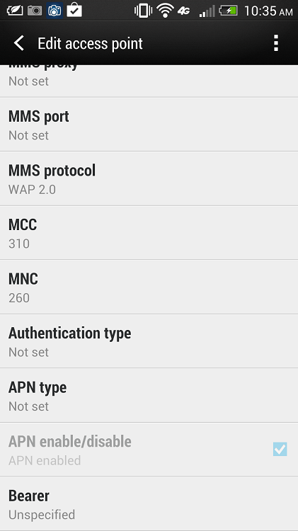

Are you still Stock ? you need to get rid of any other APN and leave only the metro one. See my link above for the correct 4g settings on metro. Is your Sim card new? are you sure it's 4g? What are you signal strength numbers ? (Settings/About/Network/RSRP: -xx).

I very much hope an apn is all i need!! I KNOW i have a 4g area because my lg esteem from metro always had 4g. But, here are those pictures, finally.

GUYS I GOT IT WORKING. APN WASNT BEING SAVED IN PHONE, too dumb to see save APN settings ;( i could cry THANK GOD!!! THANK YOU ALL FOR VERY FAST RESPONSE. LOVE THESE FORUMS!!!!
