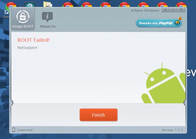

Earlier today I attempted to root my N3 and was not successful.
I downloaded Kingo.
I backed up everything on My N3 on Kies 3
I made that USB debugging was turned on
My phone was connected to my lap top and all that was left to do was click Root on Kingo. I attempted this procedure twice and failed each time.
I'm a newbie when it comes to rooting this is my first attempt.
I was thinking that the issue was with the firmware ??
like my baseband version ends in MJE and I'm thinking that in order for me to root the I'm trying to the baseband version needs to be MIE? LOL
I don't know any help would be wonderful!
Thanks
Try a different version of Kingo - 1.2, 1.5 or 1.8 may work. I can't remember which version worked on MJE.

I had problems with kingo also I tried for hours and it kept failing.I was about to give up and on my last attempt I discovered that when you turn on Allow installing apps from unknown sources you also need to UNCHECK Verify Apps Block or warn before installing apps that my cause harm.After I unchecked that it worked like a charm.When Kingo roots you phone it has to install a SU app and I think that's why it failed for me.

I tried what you suggested Corey and again had zero success. I may need to try what someone have suggested. Updating my Kingo.

Yeah galaxynote3root.com has a great tutorial and also on YouTube droidmodderx.That is where I got my info and instructions.Now that I've thought about it, I think your problem is that stock Verizon MJE firmware isn't rootable.I think the only way to root MJE is to flash Beanstown modded MJE.tar with Odin then use Kingo to root.That is how I rooted my VzwNote3 if you follow one of those tutorial it should work.I actually have also a refurbished VzwNote3, I dropped and cracked my first screen.So there should be no problem rooting yours.You should definitely check those tutorials out.Im almost positive that if you use Odin to flash MJE.tar and then root with Kingo that you should have success.

You shouldnt need to download any drivers when you plug your phone to your computer they should automatically download. From what you've wrote in you 1st post you said that Kingo recognize you device so you should be good. If they weren't installed correct then you would have never seen the Root button show up. So if you wand to be sure just open Kingo and make sure that you can click the root button.
Here is a thread where you can get instructions and file (MJE.tar) that you will need to flash in Odin v.3.0.9. You want to do method 2, it will get you to a rootable Stock Vzw. 4.3 MJE firmware.
http://forum.xda-developers.com/showthread.php?t=2528707
After you flash that in Odin and your phone reboots. Do the initial setup of your phone (sign in to your Samsung/Google/Email ect..) Go to settings "Check" install apps from unknown sources & "Uncheck" verify and block apps that my cause harm (that was where I had my problems).Then open Kingo Hit Root and if everything goes good then you should have gained root.
