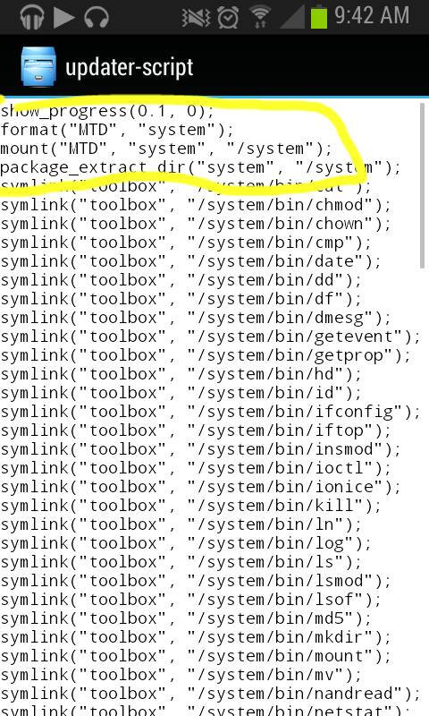

I took this pic see if help is the scrip of the cm10-2 if you see that how the recovery recognize the partitions to flash
Thanks. i think i figured out what i was doing wrong. i have to completely start over. doing it now.

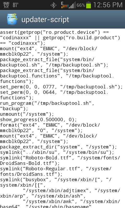

post the updater script you are using
here is the script in the deodexed rom. i replaced the kitchen generated script with the one from the odin prerooted rom.
okay, delete the boot.img .. it's not needed just take the /system/app and framework folders out of your rom zip ... I will post a link to an update script
