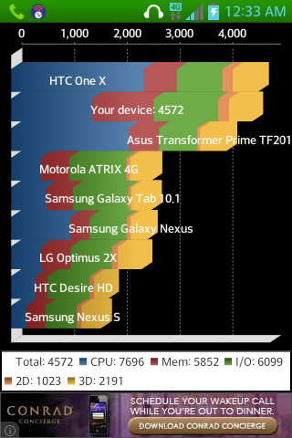

Benchmark got lower than b4
Max settings still under 5000
well could be that an odexed rom is faster, but you can not theme it and De-compile the framework and stuff
I did not do any tweaks or anything, just the de-odex and zip align
the majority of the time was spent on getting the installer script with all the right symlinks and permissions
it is just a base ROM, for others to work off of, eventually some one will make a rom using it and they will theme it, de-bloat it, tweak it, and all that good stuff
