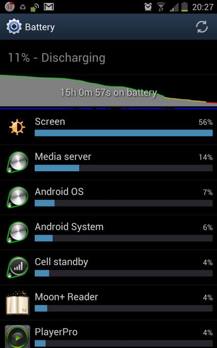

I am planning to gauge the longevity of the battery for seven days. I will let it drain to less <9 %and then charge it overnight while I am sleeping.
In the waking hours, I will use it to listen to musics all day, do e-book reading for about 1.5 hours total, browsing with mobile data for about 3 hours total, and watch video for about 1 hours total. I will turn off the wifi while I am still at work (around 8 hours off WIFI)
In the seven days, I will take screenshots of the battery conditions just before I sleep.
In the end, I am hoping that the Note can last 18 hours this way, but let's see the results.
As for starter, you can see my battery usage in a sunday, mostly at home, wifi on, used for reading ebooks and browsings. Good run life, 15 hours to 11%.
