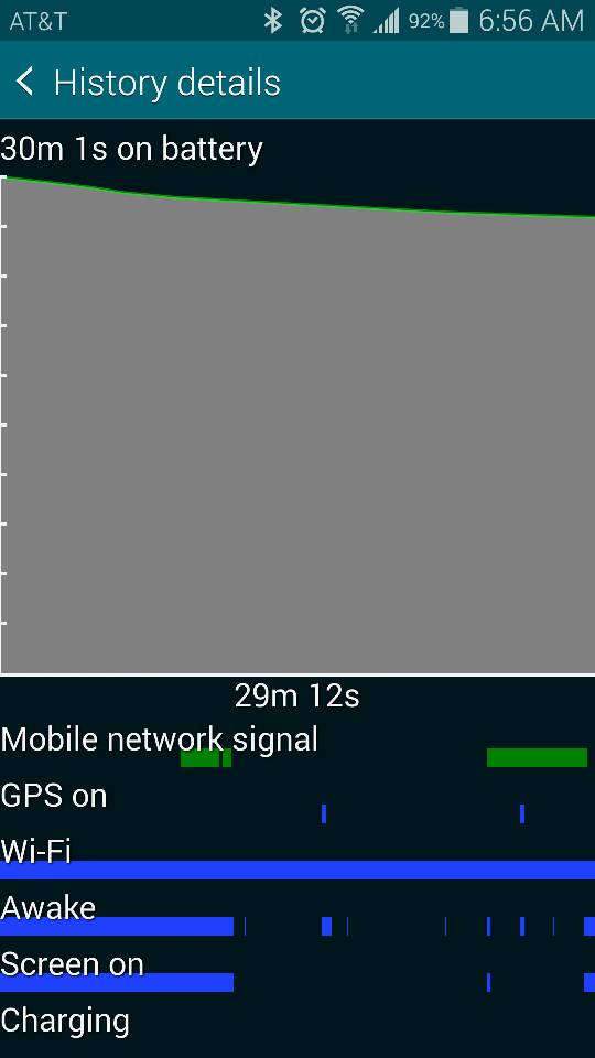

My new S5 is horrible battery life. I'm on my second phone with the same result. AT&T hasn't helped much, other than replacing my brand new phone with a refurbished one. :(
Here's an example. I woke up, disconnected my S5 from the charger, looked at the battery icon and it's 100%. Went to make some coffee and breakfast, and sat down and opened my phone settings. Scrolled to battery and it reports 30 minutes left. WTF?
lol eh? it's been on for 30mins with 92% charge left. Mine uses about 1% when idle per hour, so your power saving techniques and settings could do with a tweak as its used 8% in 30mins.
Having bluetooth on all the time will drain the battery. Also try turning off your wifi when its not in use will help a little as well.
