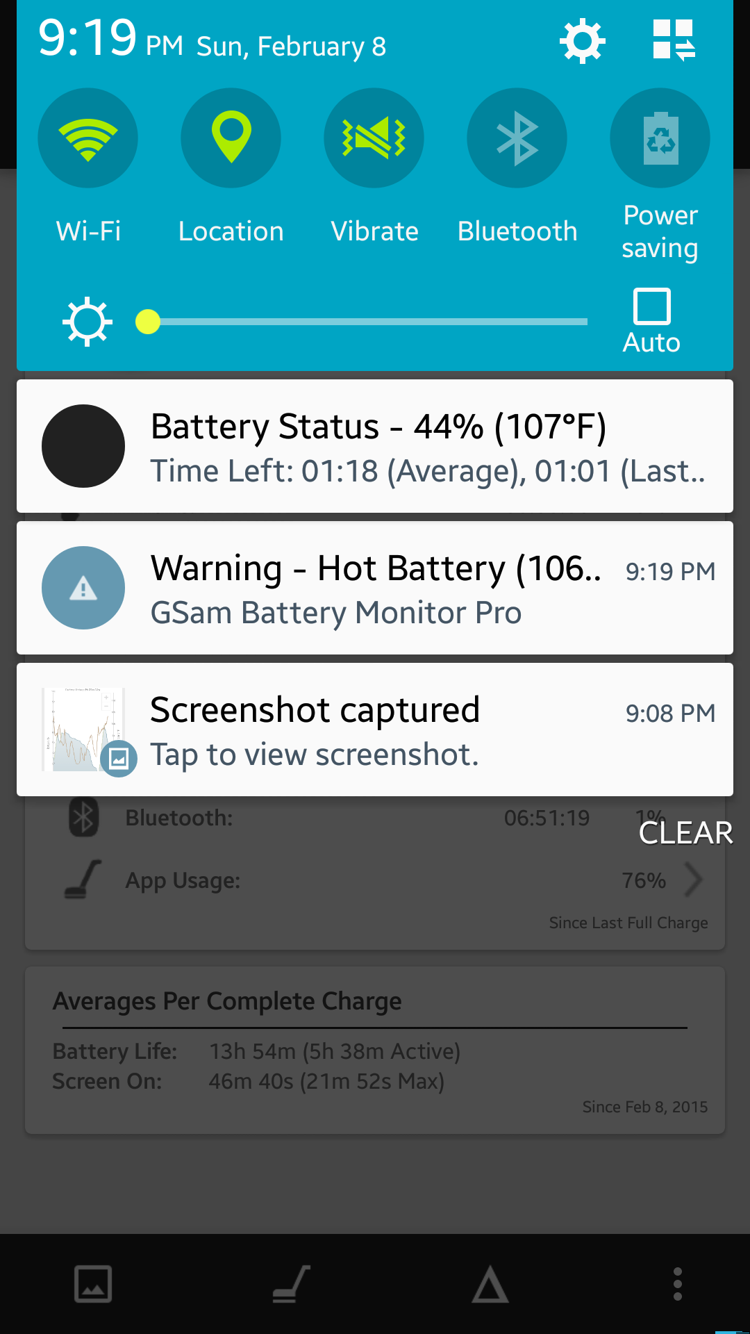

Wow...i updated to Lollipop 4 days ago and I have had to charge my S5 at least a dozen times. I have tried power save mode, disabling every nonessential app and anything else I can find in the forums.
I used to get 15-16hrs of battery life (6am-10pm) with charge to spare, but immediately after the update my CPU sits maxed (monitored by Micro CPU Monitor) and constantly overheats (GSAM Battery Monitor). The phone went from 95°F to 105°F in 10min with standard use. I only had it overheat one other time in the last year (on my dash in the summer). I hope Google will replace my battery because this abuse of it is going to shorten the life considerably!
See screen shots from the last charge at 4pm to now (10:15pm) all while UNUSED and in powersave mode plus battery at 106°F (a new record for me)!
A factory reset might fix things (back up everything important first).
Lollipop was quite a big update and usually after a big update, when wonky stuff happens, starting from scratch again helps :thumbsupdroid:
