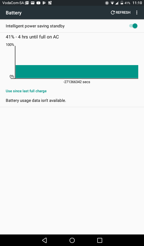

I've a same problem, and when I play fallout shelter for several days and my battery is 100%, it magically drains to 41% of battery when I when I disconnect my charger, restart my tablet and connect the charger again.
Model: Vodafone Smart Tab 2
Regards: Modiken Silvia Mapeka
Screenshot below
