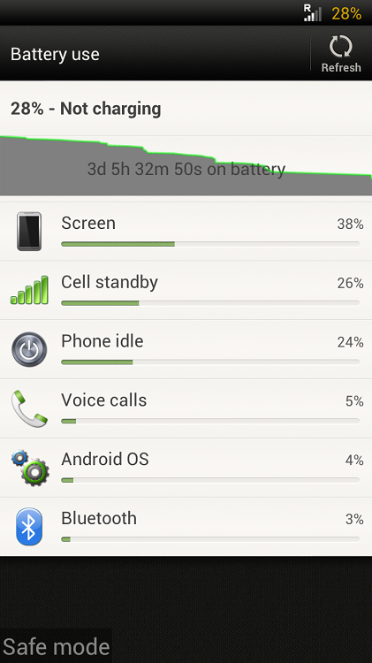

K9nut, can you post a picture of it please, it'll look like this:
8.5 hrs is definately very bad, here is mine after not much use whilst on holiday (didn't want to incur any hidden data charges)

Also, comparing battery times is such a hard thing to do because we all use our phones differently.
The screen and data connection are normally the biggest drainers of battery.
Obviously playing games and using apps or doing all these things at once is going to kill the battery quicker.
