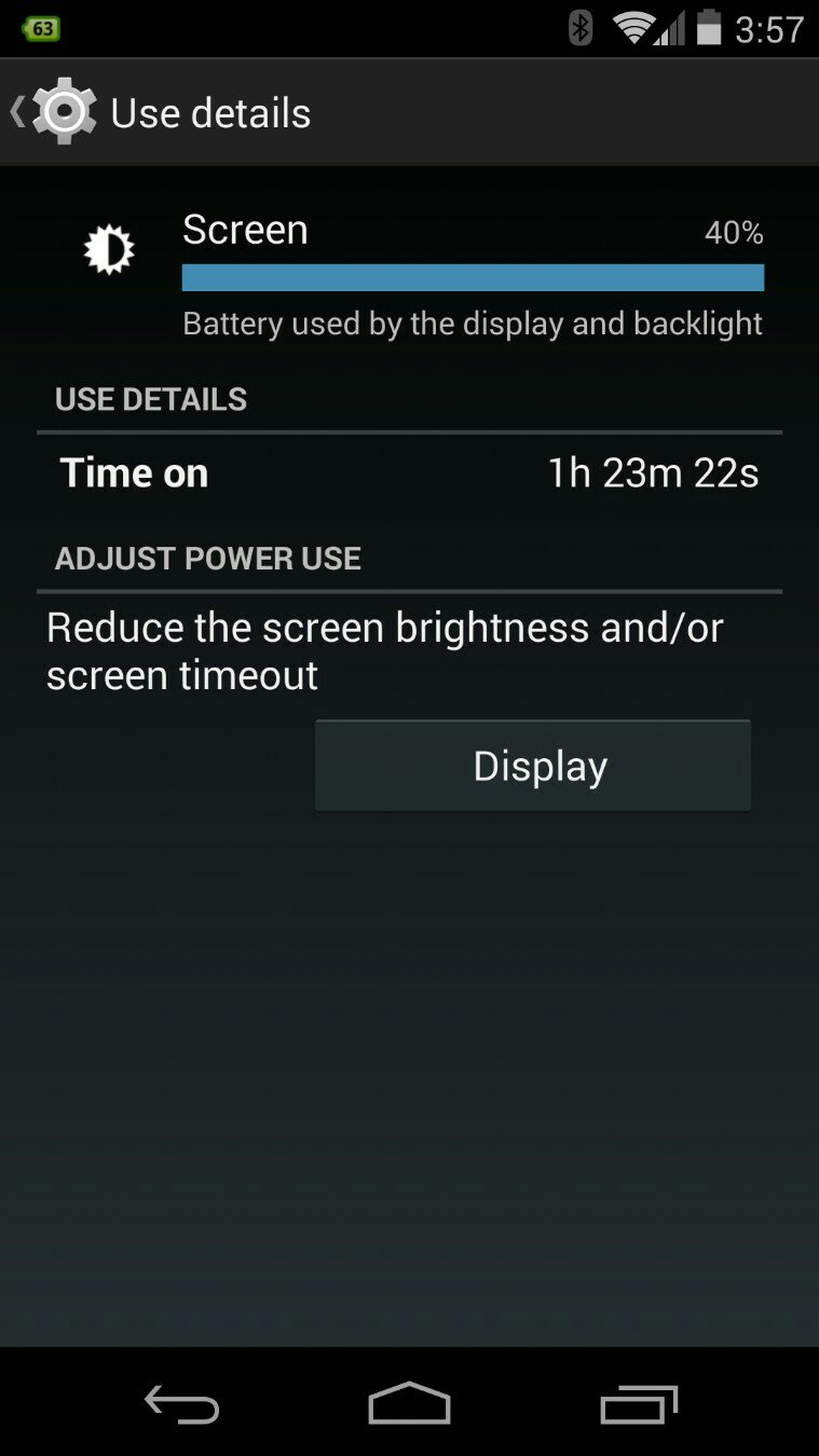

Only 1hour and 23 min. Has been almost a regular use day for me on WiFi most but in LTE for a couple of hours too. I will post all settings I have later once I am through the day.

I turned off what IMO are the biggest useless battery hogs: Hotword recognition (the "OK Google" thing); Google Now; Location reporting; and GPS (use the Battery Saving option in Location settings). After 12 hours of my typical usage, some with WiFi and some LTE, I'm at 80%.
